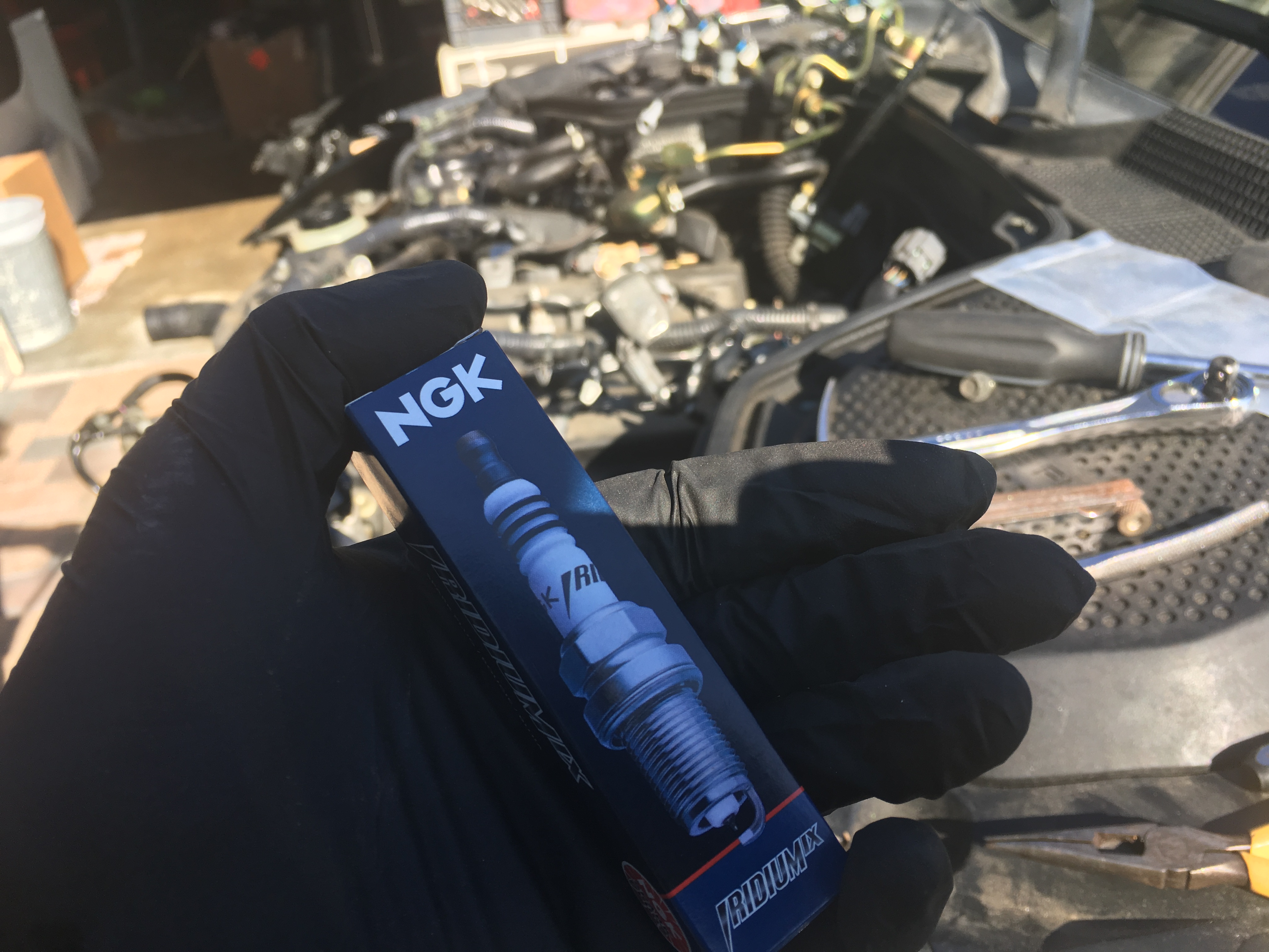

Old Dec 20, 2017 | 10:26 AM
CK_32's Avatar
CK_32
Joined: Jan 2016
Posts: 3,635
Likes: 366
From: California
NKG iridium IX LFR6AIX-11
