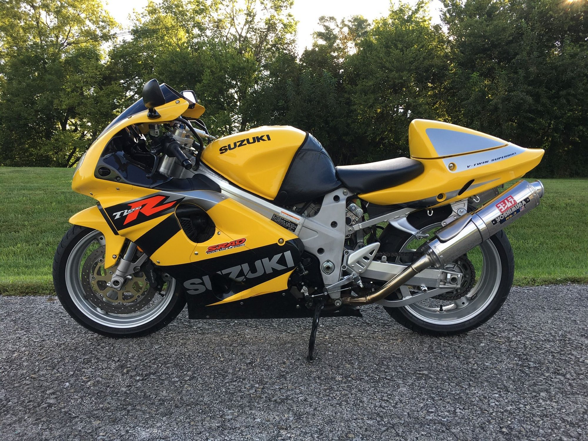

I have a few guys messaging me for some deals on kits (used) but they have everything... also haltec, injectors, and pump. If I decide to go this route I値l just need to save up for the tune. One kit is a single and one is a twin.
Also do I have my bike up for trade too (this is where my cash will end up coming from) or I may trade for a car that has the parts I want and pull them... would like to have a second drivesnle car after (looking for something to give my kid)...
once I decide I値l start the build thread and see what I can work out.
Pic of my bike for attention

A lot of people here have experience with Haltech and could help you with trouble shooting and/or a base tune.
What twin and what single setups are on your radar?
nice bike!
