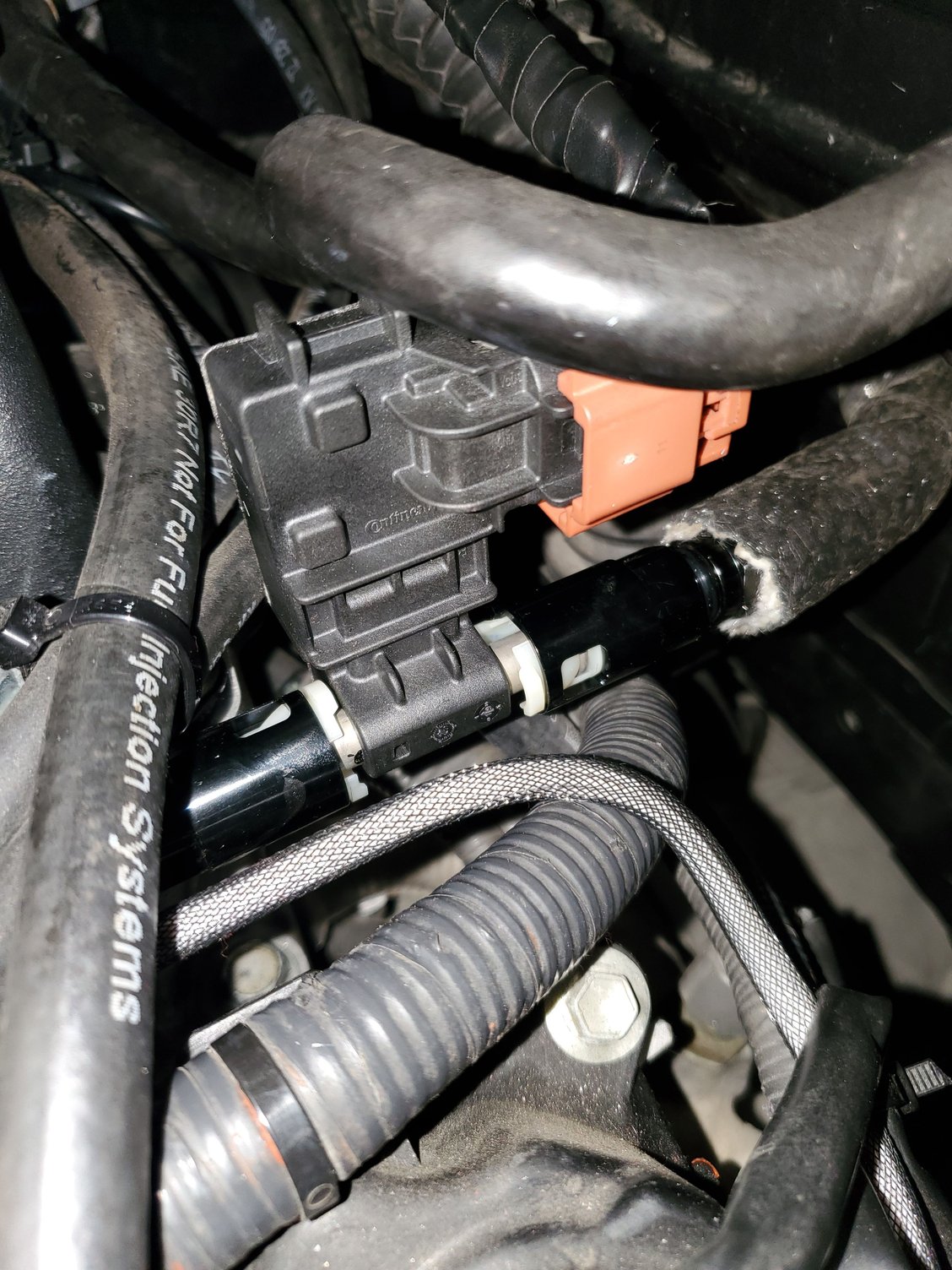

Vibrant adapters for the ethanol sensor.

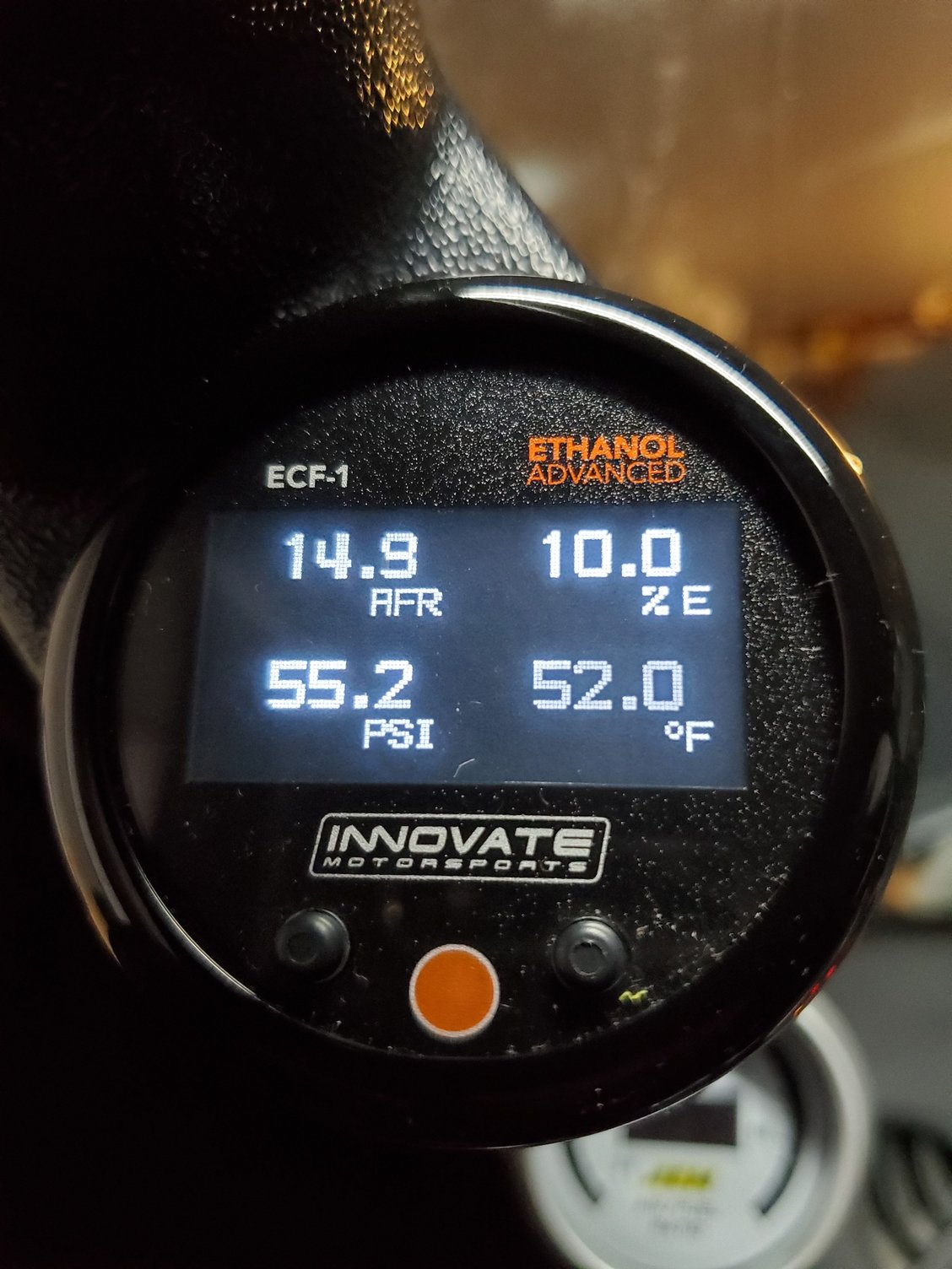

Ethanol and fuel temp sensor for the ECF-1. Connected on the return side of the fuel rail.

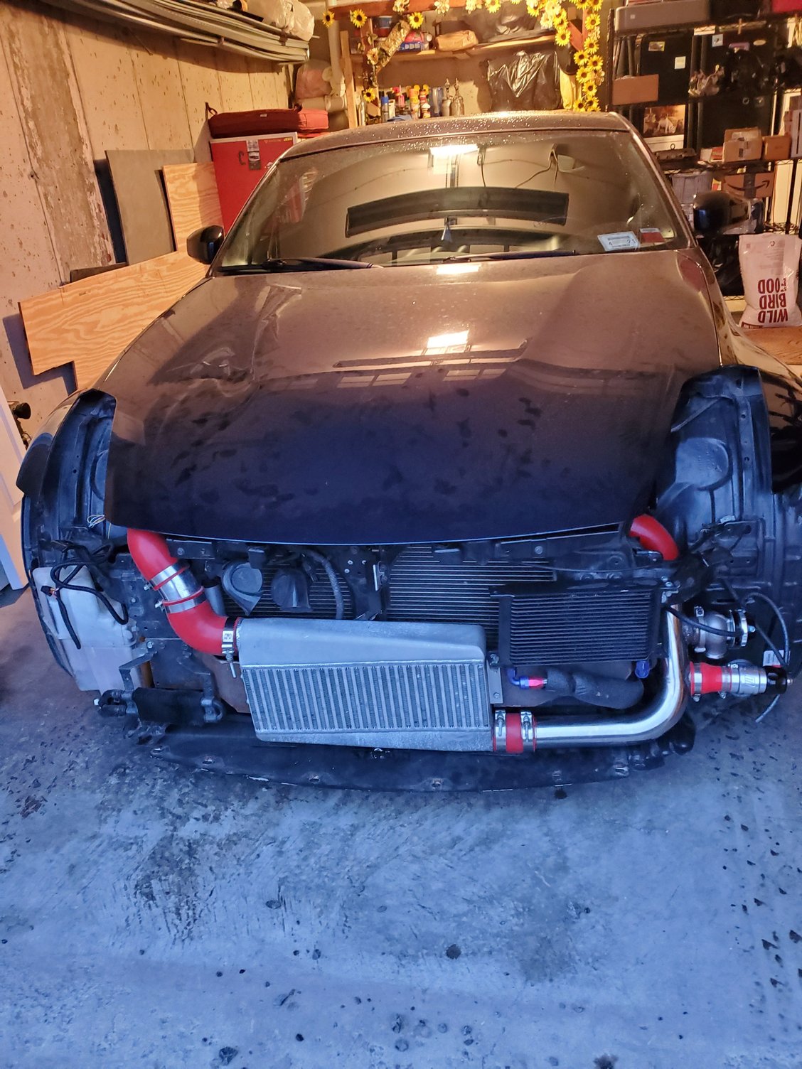

Showing some of the setup. Cars a little dirty.
12 psi on wastegate using the eboost2 boost controller.
