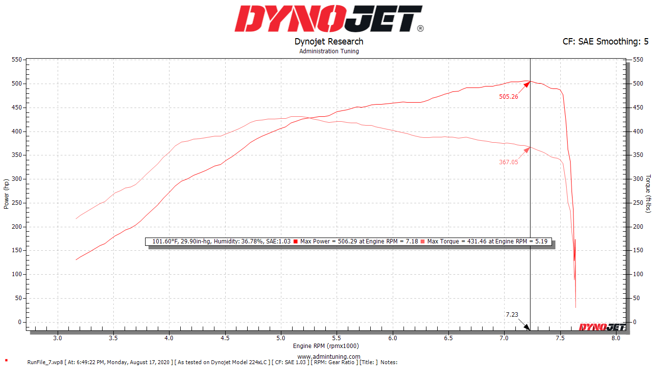

So I wasn't happy with the first tune. The afr's were always hunting, the idle and rev hang was GARBAGE, and it seemed like it should be making more power than it was/ what others have made with this kit at this pressure on this motor. I reached out to a few of the big shops to get recommendations on what I was seeing with my tune and what to do about it. I ended up planning to do a dyno tune with Admintuning in Houston. I had a trip planned to Tail of the Dragon in early August, so I scheduled the dyno day for July 20th. A few days before the dyno day I got sick, which threw a huge wrench into my plans. I rescheduled the dyno day til after my trip to the dragon and reached out to Admintuning about doing a safe etune before hand. He has tuned quite a few of these kits, and even a couple others at nearly identical mileage as mine. (180k). The etuning was pushing it on having enough time, and I ended up trailering my car out to the dragon and got the final etune map flashed about 15 minutes before our group left for the first day of driving. The tune was so much better. Night and day on the smoothness, and power.
After the trip I went back to Houston to get the final dyno tune on the car. The tuner did a great job, and picked up quite a bit of power from the previous tune. The car is mind bending to me now. It also still made the 5 hour drive from Houston back home with zero issues and felt like it did cruising NA 6 months ago except quieter. Getting right at 23mpg at 75mph on the drive back when I filled up and calculated it. Super happy with how it turned out.

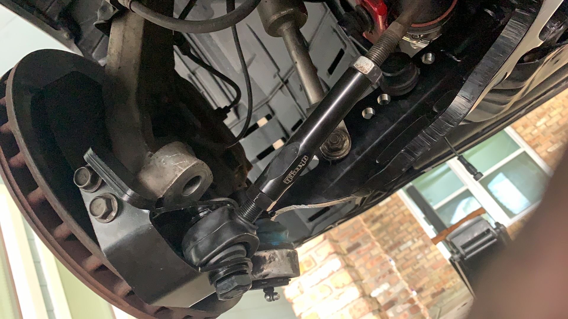

Got the GKtech arms on. Completely solved the issue I was having with loose sphericals. The arms are quite beefy, and a bit of a pain to install in my particular case. They seem high quality though. They also added a ton of clearance from the turbo piping. My compression rod was smashing my cold side piping on certain turns and these eliminated that by eliminating the compression arm.

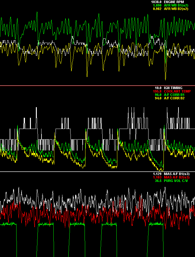

I am having some weird idle oscillations sometimes that seem to follow the behavior of the evap solenoid. The fsm seems to say that the evap is not supposed to open lower than 2k rpm, but this is at 900-1000 rpm idle and it is cycling. I tossed a screenshot of the log below and can share the log if anyone is interested. It almost seems like I have cracked my charcoal canister that is allowing it to behave like a vacuum leak controlled by the evap solenoid.

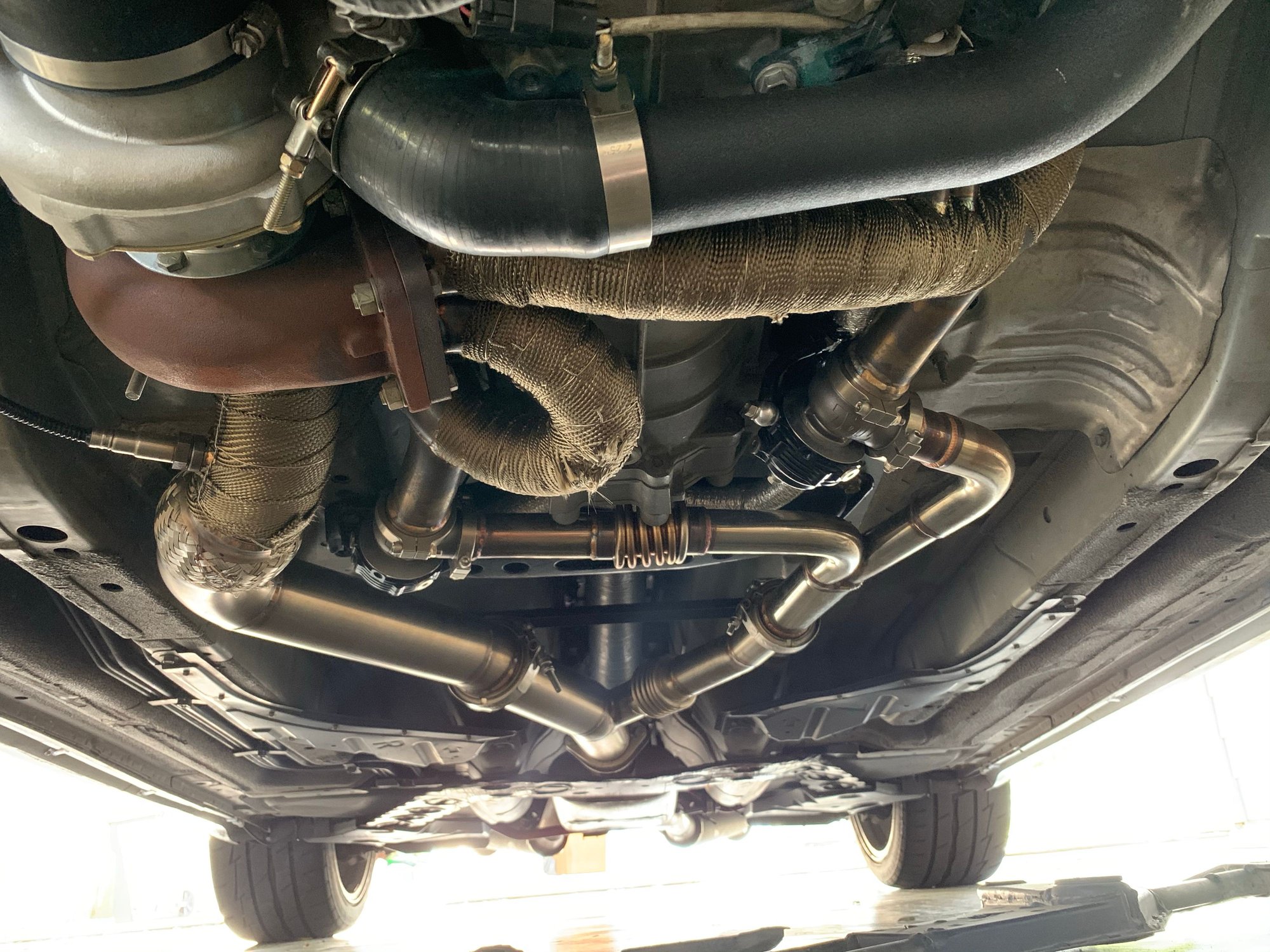

The car is still running great. The idle oscillations ended up being related to the header to midpipe gaskets leaking and messing with the Ox sensors. I tried the gaskets that came with the kit, Z1 metal ones, and have finally found that the Zspeed copper gaskets to be the most successful. Ideally I will go to vbands, but I am in no rush to pull my headers, so I will bundle that with a future project.
With the GKTech arms.... man is there a lot to unpack there. There are a few absolutes about the GKtech system:
The rod ends are garbage. Total junk.
It is a drift focused steering setup with very little Akerman and a ton of castor.
It binds up the sway bar endlinks.
They will widen the front track width by 2" minimum.
The GKtech front lower control arms failed on me. The front driverside lower control arm failed at the rod end that connected to the k-member. Thankfully this occurred pulling into my work parking lot, and the accident was minor in damage. Had it happened going over a bump on the interstate 10 minutes earlier the car would be totaled. The failed rod end allowed the LCA to disconnect from the car and the wheel and tire to smash back into the body. The tire and my driverside fenderliner were the only damage and have since been replaced. I have more images of the failed rod end if anyone is interested in their **** design.
My immediate remedy was to replace all of the rod ends with high grade aurora rod ends. A few hours of work later and I was confident that the control arms would not snap off of the car again. I was still having issues with my 285 with tires in the front coming in contact with my fender, and at 2.5 degrees of camber, I was already running more camber than I ideally wanted.
