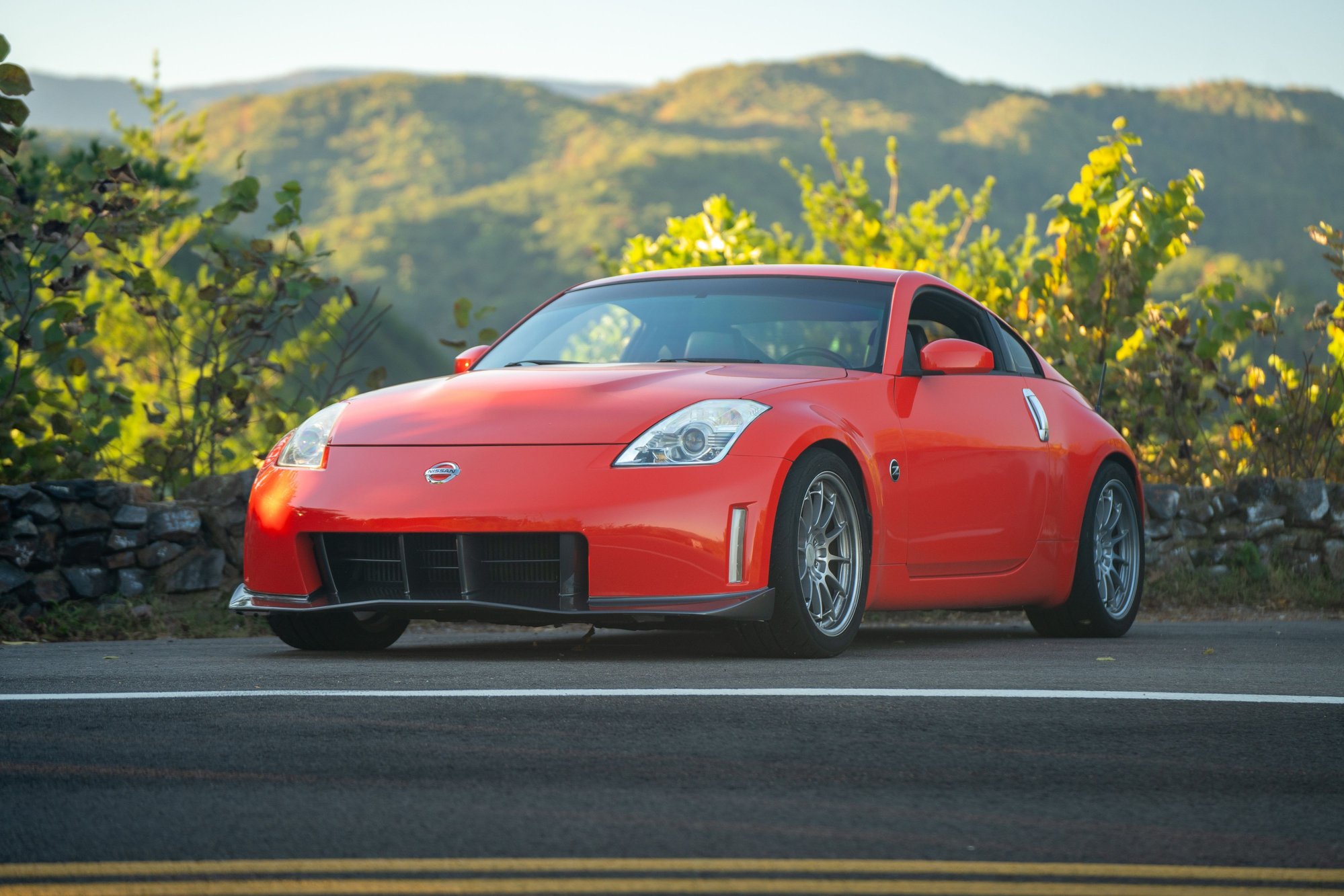

It has been a long time since I have taken good photos of the Z, but a friend of mine that knows his way around a camera convinced me to go out and take a few shots. The Z still cleans up nice for 16 years and 207k miles. It is nearing the last few weeks of daily duty though before getting to spend most days in the garage.
photo credits go to my buddy, lsxmack.

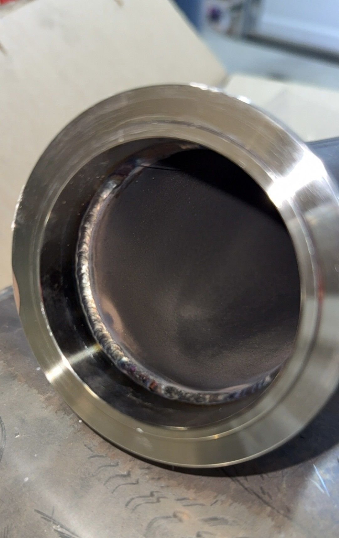

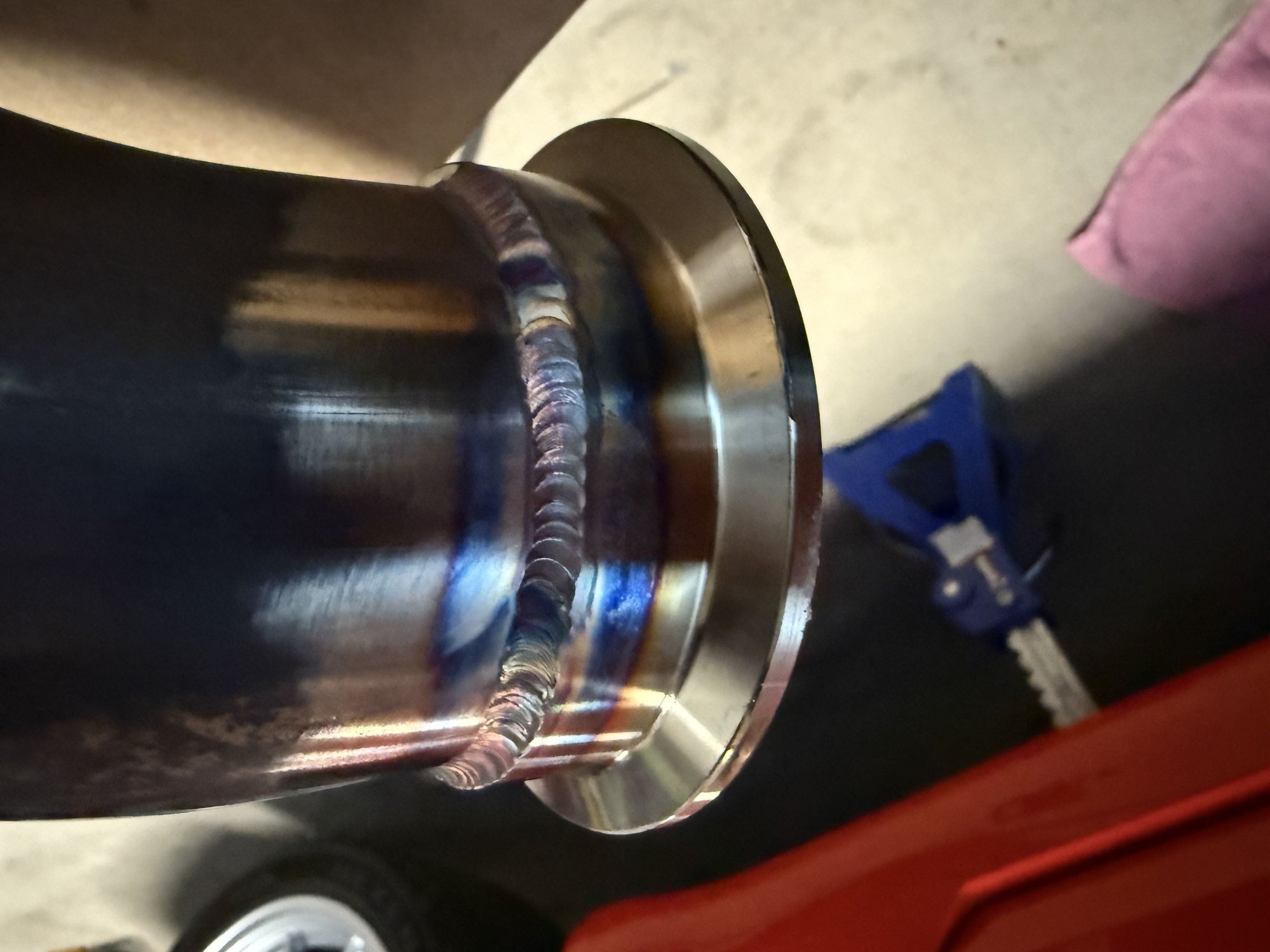

Went to the Dragon again and did ~1300 miles in the TN/NC mountains. Such a nice area of the country. While out there my Motordyne Nova muffler decided it had enough and split. It sounded horrible. I spent a while very low in the past and have had to weld up the muffler a couple of times, but it was beyond repair. Not neccessarily mangled, but needed rewelding on nearly every joint of the muffler. The ports and top and bottoms of both end caps had splits, along with the repair panels that I had previously welded in. I reached out to Motordyne and they had an extra muffler that they were able to send me and I replaced it. I also added some additional V-bands to make it removable without dropping the sway bar and W brace. Huge improvement and I am happy with how it came out. While it was dropped I also redid my diff by restacking my Tomei LSD plates to soften it a bit. Last year and this year I had a few times while driving that I could feel the diff unlock mid corner and it is an unsettling feeling. I hope that by softening it's lock a good bit it should make it a more gentle engagement. Anyway, here are a few pictures. ​​​​​​​
