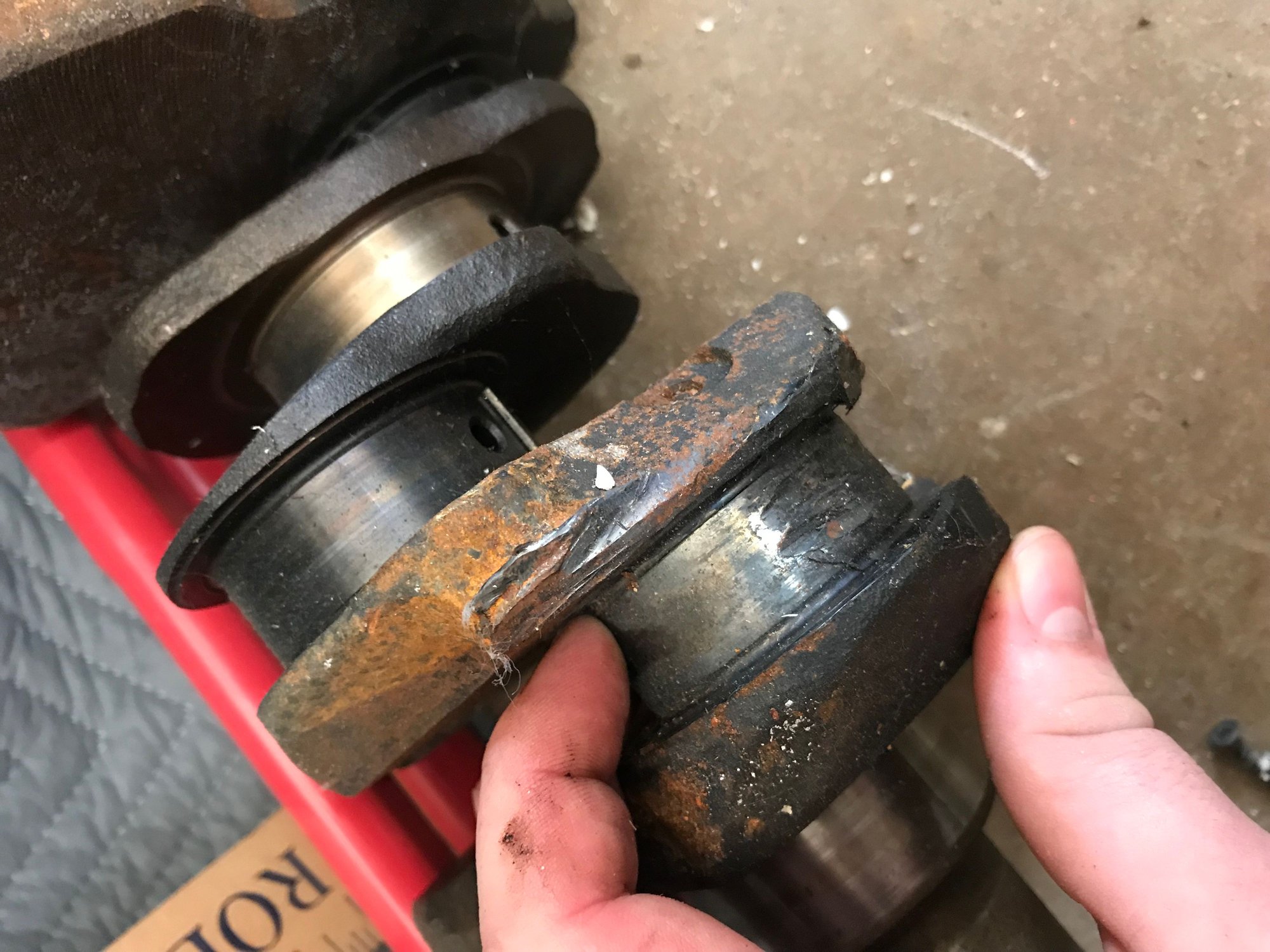

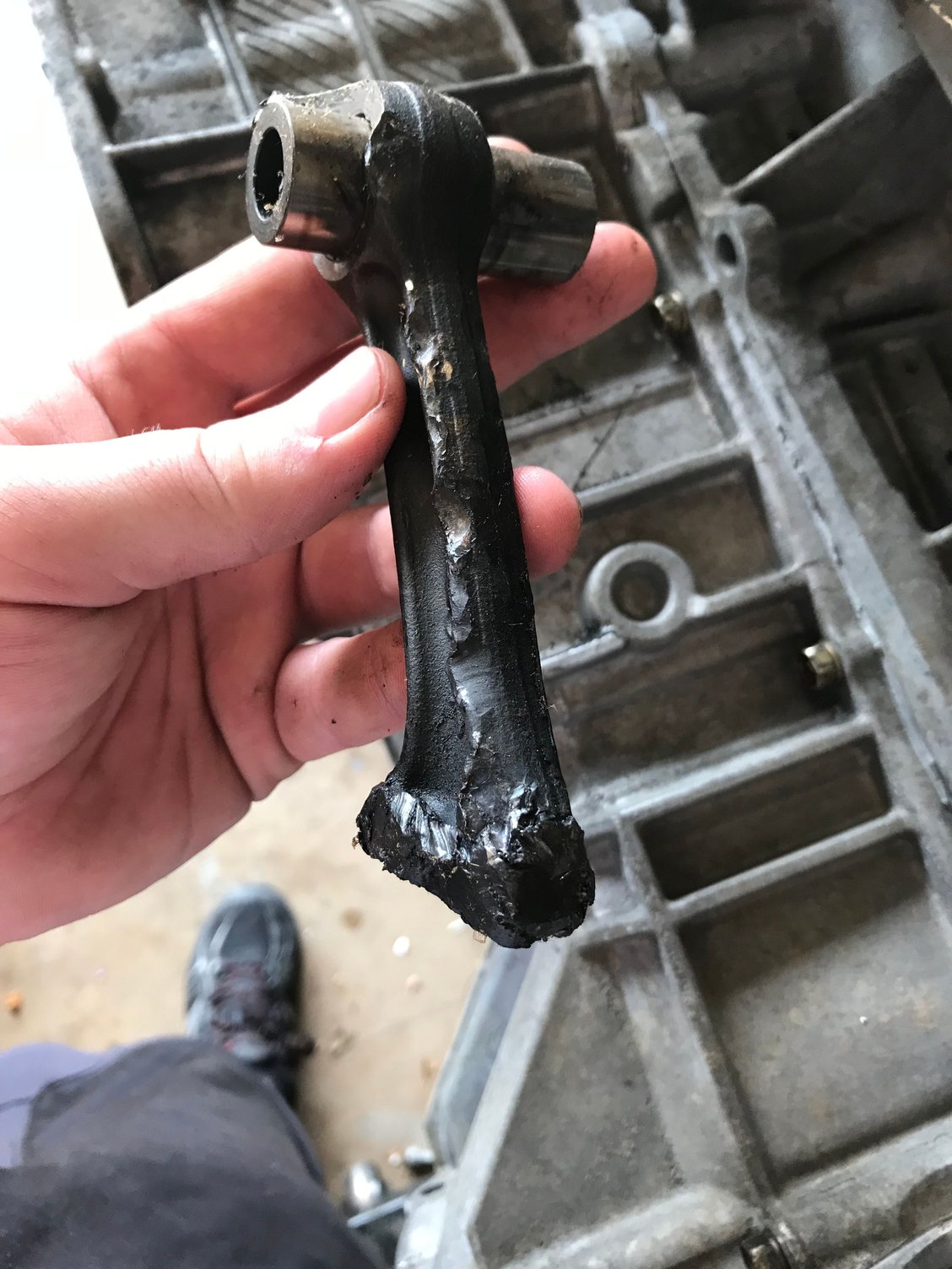

Here are the two junkyard engines they were both pulled from G35's
the one on the left is a dead engine I got for $30, what I'm told happened is one of the connecting rod bolts failed for cylinder 2 and the crank knocked the connecting rod through the block. this is my Jig for the turbo fabrication. Ill post some photos of the carnage below. needless to say there are no usable parts from that engine. The engine on the right will be built for the project and at this time has already been completely disassembled down to the bare block

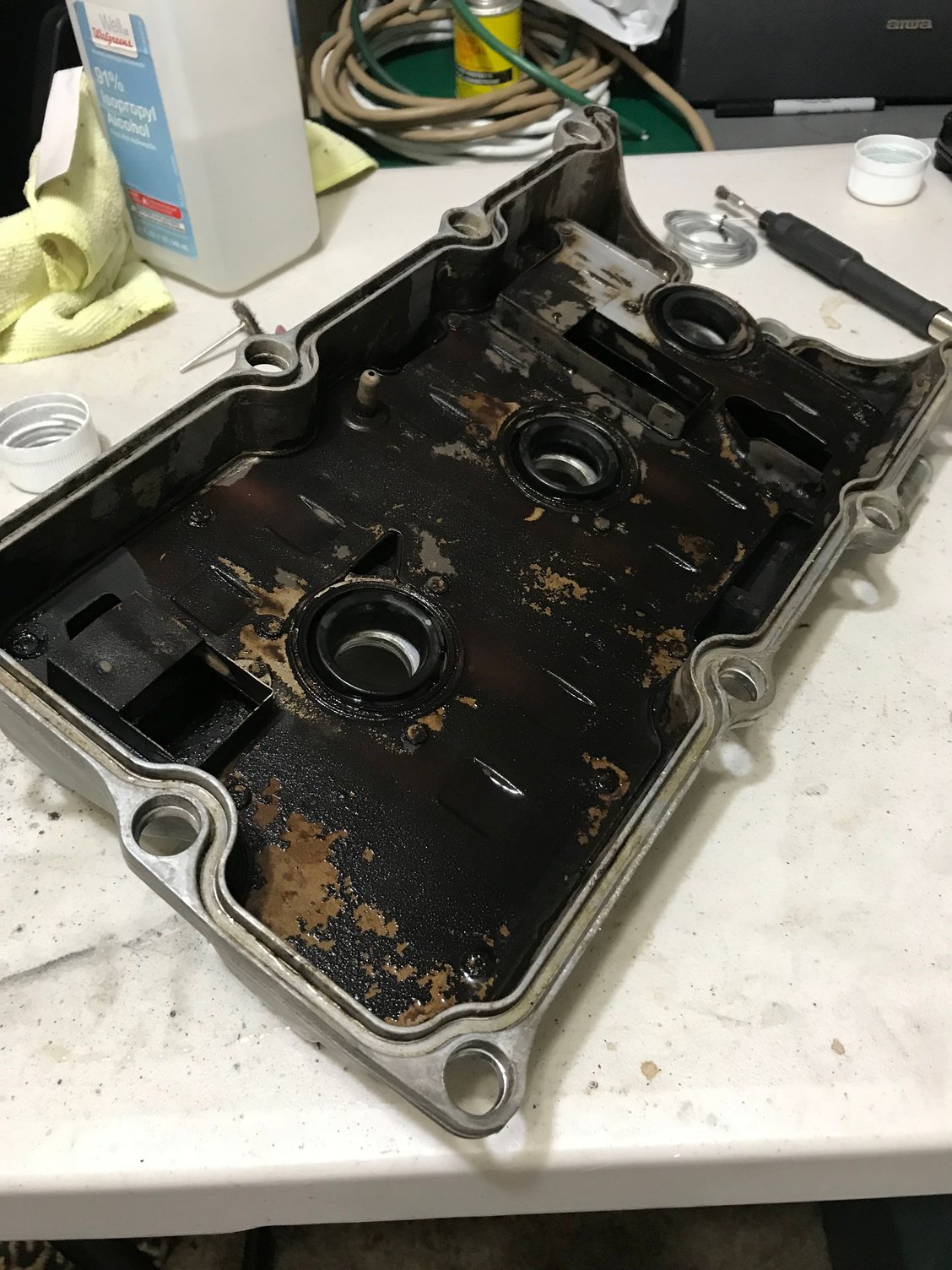

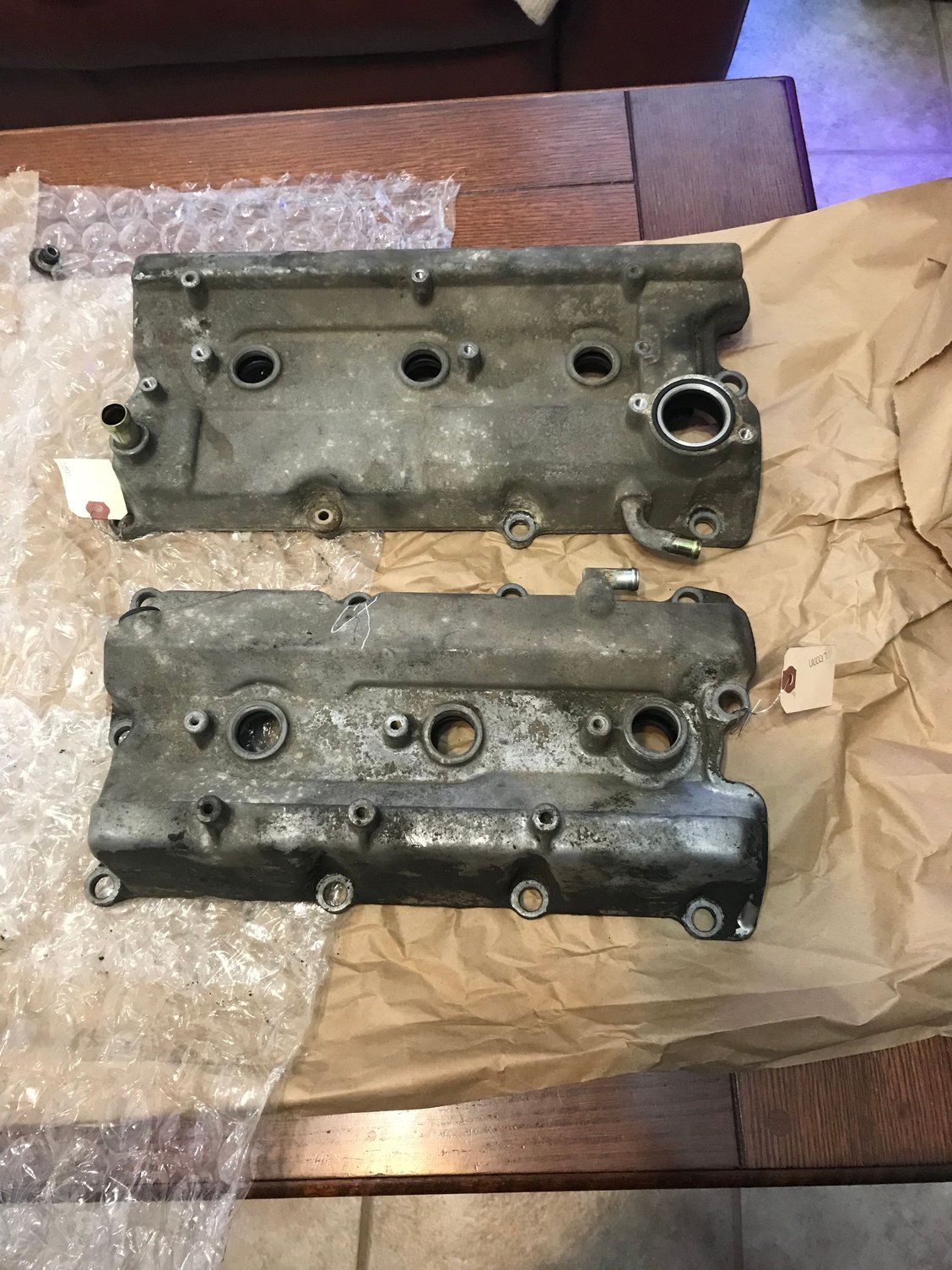

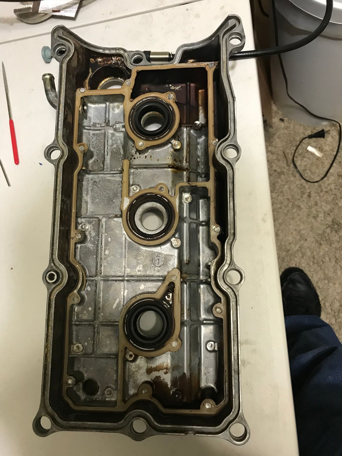

a few old pictures of the Pathfinder Aluminum valve covers, I removed the baffles as i will be using an alternative PCV system

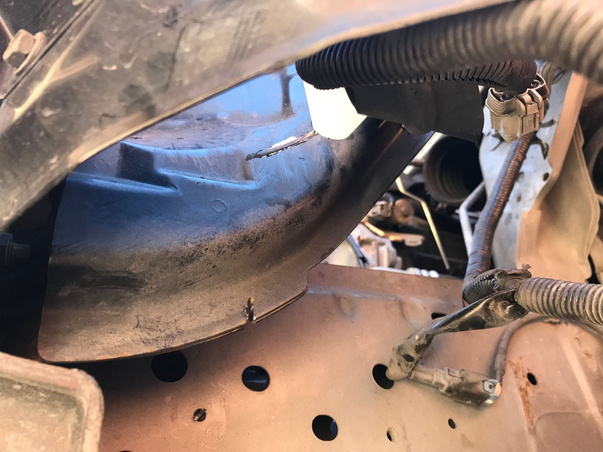

with the position of the turbo there is just enough room to route the air intake up under the front left crash bar rail, and have the air filter under the left headlight, which leaves a small amount of room to rout the cold side charge pipe around and over to come up through the hole right next to the headlight. I actually originally didn't have enough room there so I had to cut part of the Headlight bracket out

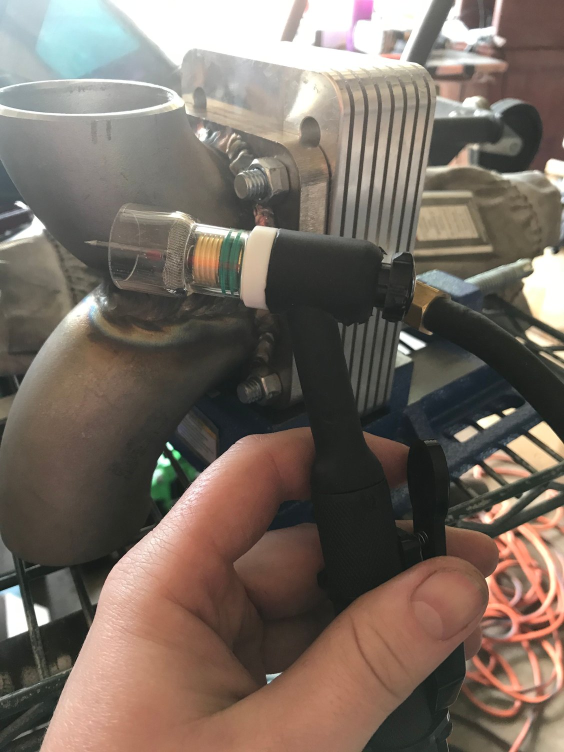

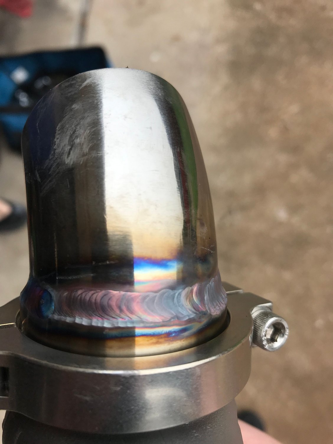

Welding, I have a full Tig welding setup at home with back-purge capabilities. Its actually my welding method of choice lol My personal machine is an EASTWOOD AC/DC 200 I have a full set of gas lenses and Pyrex cups up through #12 numerous types of Tungsten and sizes and an 80 bottle and should I have need of something with more punch, at work I use a Miller Syncrowave 200 and the shop manager has already oked me using it for my project off the clock, I'm lucky that he is also a car nut lol

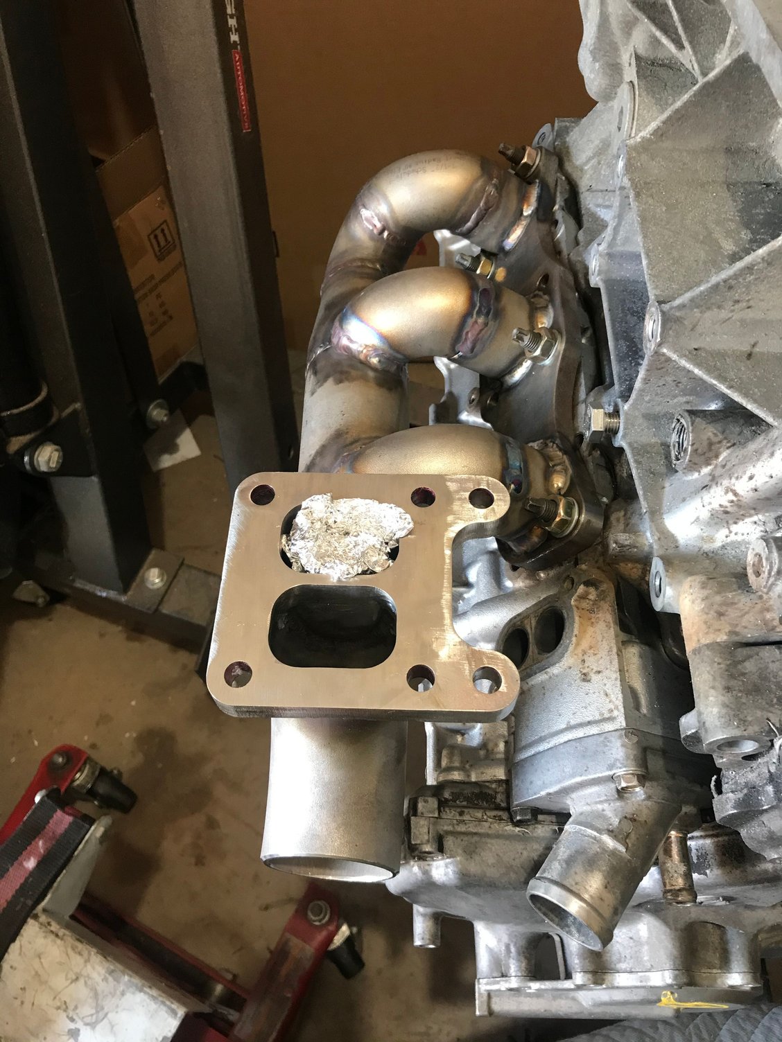

Later today ill post some pictures of the manifold fabrication the drivers side is almost done except for the wastegate positioning

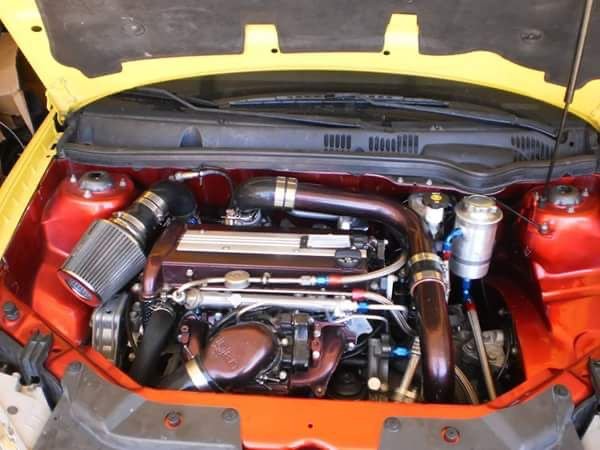

also I know its a bit off topic but i wanted to share some pictures of the fully built 2.2 I had before the Z. it unfortunately was totaled when I wrapped it around a pole and put it into a ditch
