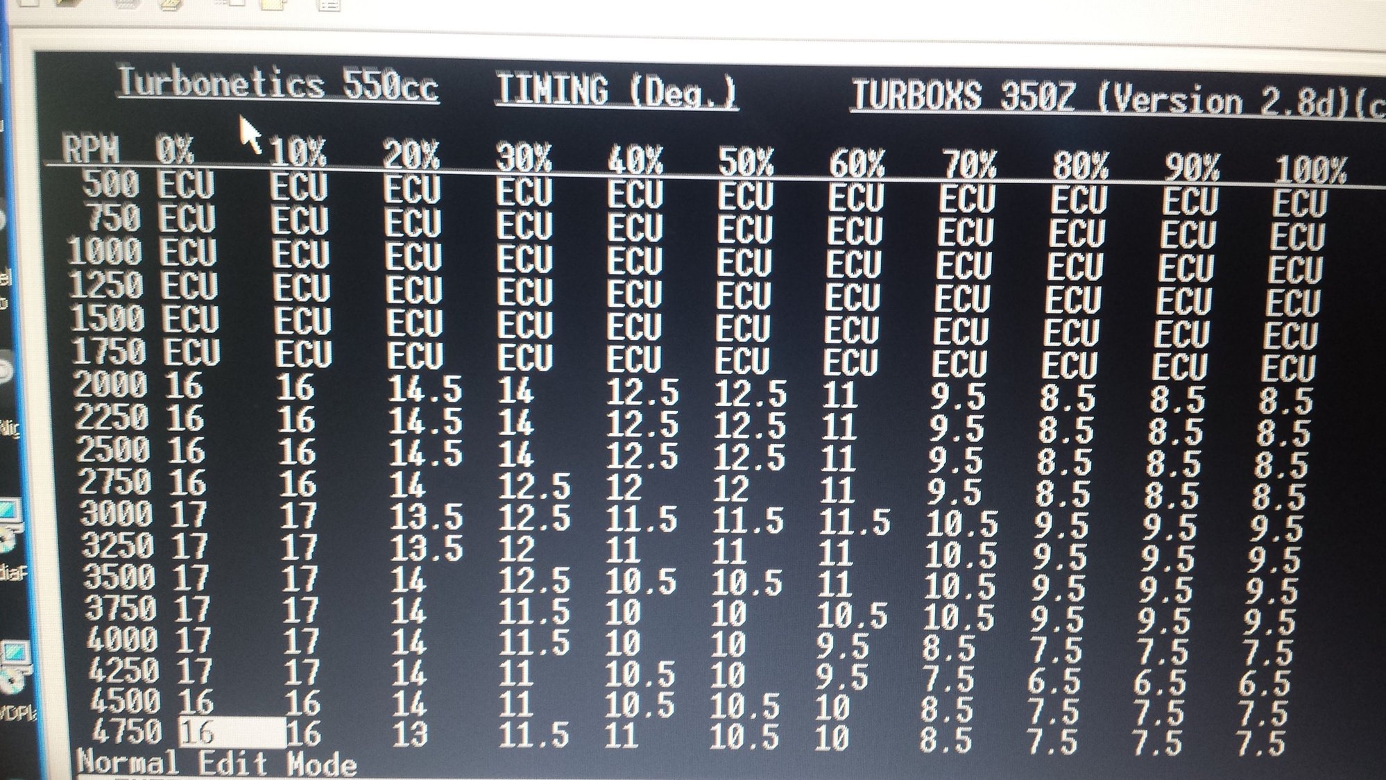

334whp at 6psi seems about right? Here's my timings around the same boost level.

If you are only 6PSI, that's Way to little ignition timing, even if on 91 pump gas.
Lots of power left on that.
I did'nt even start pullin g timing from the stock map in till 8psi on 93 pump gas.
I'm an idiot. I pulled the timing instead of advancing. /facepalm
