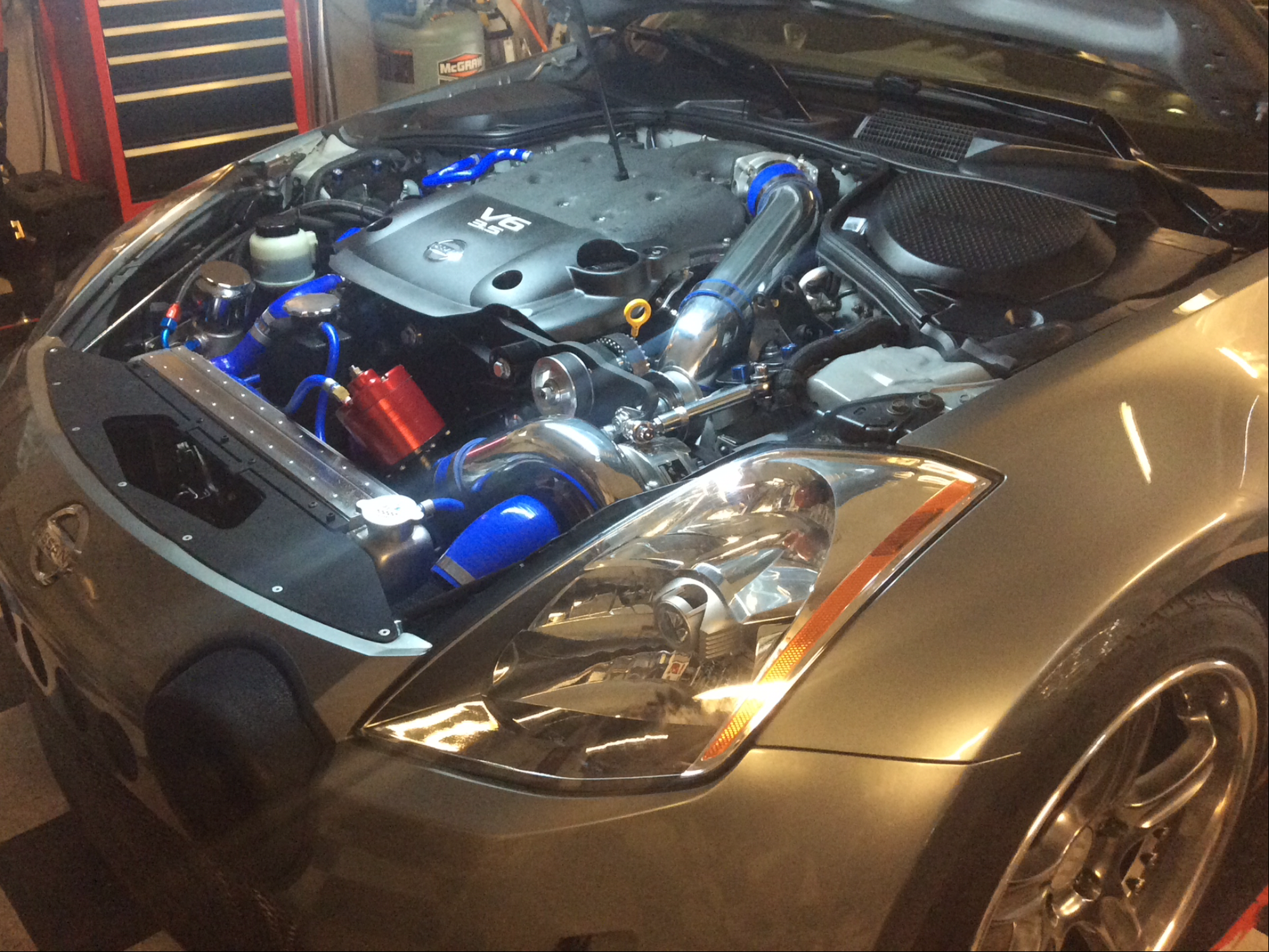

Hi, I'm TimRod, kinda a Vortech Guy.....
Read My Sign.
icer5160 is right, A Vortech tuner kit is the way to go.
I've been here since the begining of My350Z.
If you need help, best to get on Facebook, you can look for my in the "Boosted VQ" Group
Also, read up on me here and on Facebook.
TimRod

That is one SAVAGE SC 350Z you got Oldman!
If C.A.R.B. get's demolished, I'm going to be bugging you!
Cheers!
