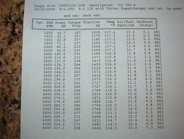

Here is the dyno with A/F...........it has not been tuned SS Box is straight from Vortech. Ran good when we dynoed it and test drove it.
