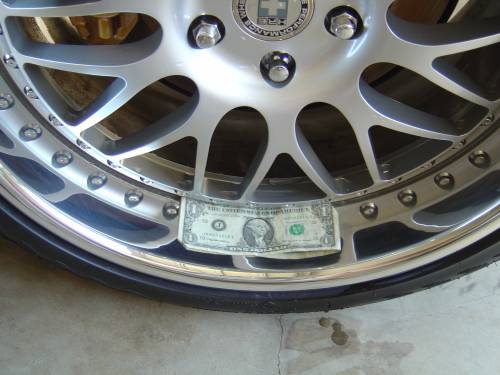

Toyo TS-1 275X35X19 rear on 19X11. You need wider and sticky
wow u can fit a lot wider tire on that rim can't you! only 275??????

275 has got to be too small for 11 wide rears. I was told that 275 was the ideal size for 9.5. WOW. Must just be really tight

my 235's were on 8.5" rims so yes, 275 sounds too small for 11"
that would be some really tight sidewalls if you could even get them on there
Yep could but waiting for toyo to make a 295 which is in the works right now. As for fit here is some pics
