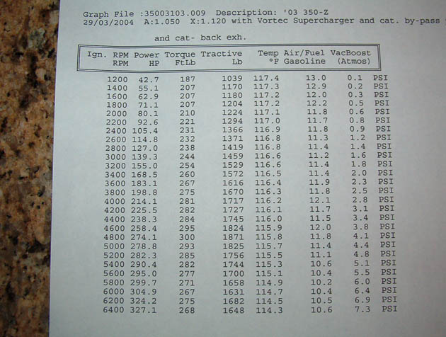

Here are the A/F from the SS Box directly from Vortech, NO TUNING WAS DONE.
