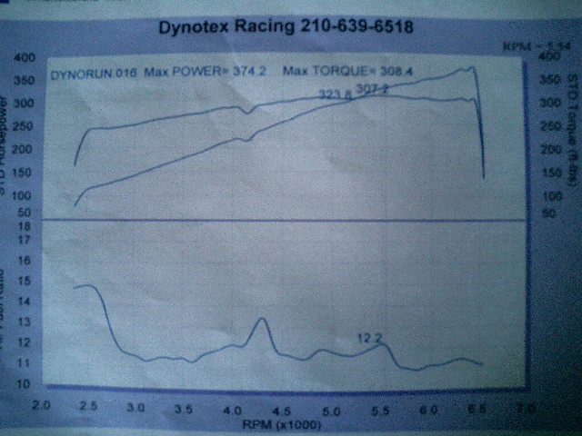

Here are the new numbers after 16 runs while tuning the SS box.
I did 282 couple of days ago. This clearly shows that Vortech messed up big time!!!!!!!! Though , I am very very happy with the new numbers

A/F is still a lil scary but more power than before. Almost 14.0:1 at the peak of your torque, could be bad news someday.

I know the picture is slightly blurry, but it is peaking at 13.3.

After changing out the plugs, I'd tweak the fuel map a bit around 4000-4500 to see if you can get rid of that spike. I'd also add a tiny bit less fuel at 6000 rpms.

Ya that spike is the next project !! Hopefully the spark plugs and little bit of more tuning will take care of it.

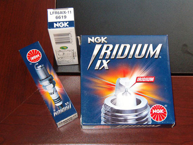

Any spark plug recommendations?

One step colder iridium.
One Step Colder Iridium NGK's......this is what I have..........
