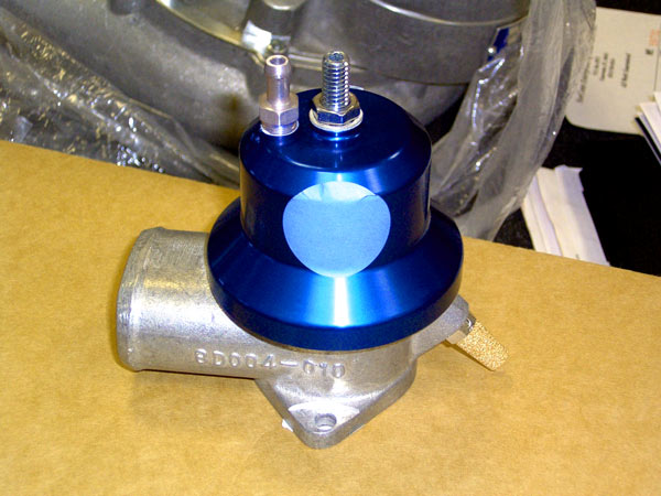

Originally posted by kjbalto
I don't like the sound of the HKS. I just listened to the sound clips on the site Cheston posted above and the HKS sounds like a bird that got shot. I like the way the turbo xs sounds on the srt-4 on that site.
I got this one in the mail today.........
(along with about 80lbs of other blue and silver goodies!!!)
yippeeee!!!!
the quickening!!
