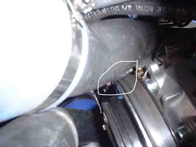

Well I have finally had it with the vortech kit. I've had the kit since the begenning of December and have about 2300 miles on it. It has been to vortech 3 times to fix problems. First problem pulley rubs the rib on the hood. They said it was because the belt was loose. So they tightened it and it still rubs. Second was I had pinging around 5000 to 5500 rpm. Nothing was done so I asked for R4 software and fixed it myself. Next was I noticed that my ac pulley is all shiny and has been rubbing the up tube from the intercooler. Called vortech and they said to loosen up the clamps and reposition the tube. So today I put car up on jack stands so I could get to intercooler and loosen clamps. Well this is were the real problems start. First the up tube has been rubbing on the other side even worse than were the pulley was hitting it. It is almost wore through. So I took off the pipe that goes from the intercooler to the up tube so I can see what its going to take to fix the problem. Well I am going to have to go to my friends shop and custom fit it by cutting and welding it. Even after doing this it still looks like it is going to rub the fender up higher. Looks like I'm going to have to make the tube out of oval tubing so it will clear. Won't know until I first fix the other problem. Next I noticed that the intercooler is only mounted on the passenger side. If you push up on the bottom it is sagging down. So when I fix the tube I will weld on another mount to support it from both sides. Next is the worst problem of all. When you look at picture you will see. The fuel pump has this piece of hose that connects the pump to high pressure fuel line. Well this piece of hose looks like heater hose or maybe fuel hose,but it is not high pressure hose. It is cracked and swollen. Pretty scary. Well if I could take the kit back, I would. I like the power but I don't need all the problems that are happening. I wonder whats next. So I would take a close look at things to make sure nothing is rubbing and check the pump hose for sure.
Attached Thumbnails Vortech problems owners beware-vortech-problems-011.jpg-1.jpg

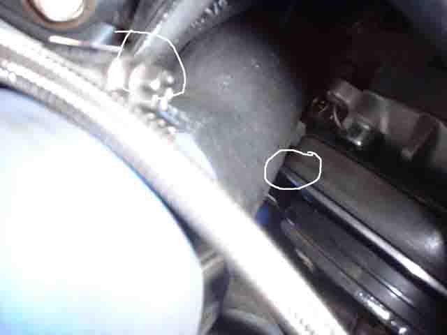

another pic
Attached Thumbnails Vortech problems owners beware-vortech-problems-002.jpg-1.jpg

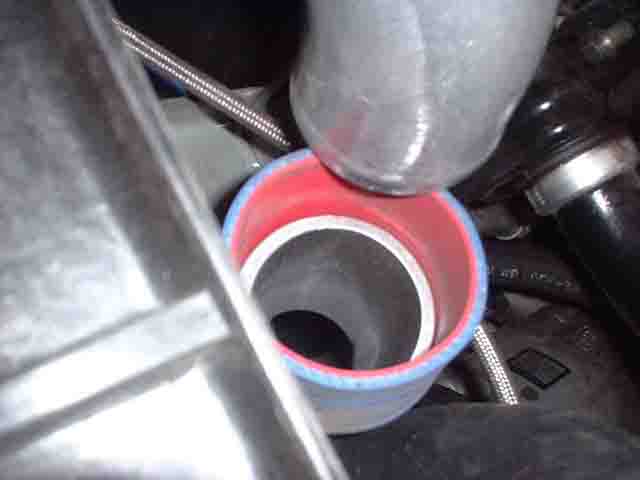

another pic
Attached Thumbnails Vortech problems owners beware-vortech-problems-004.jpg-1.jpg

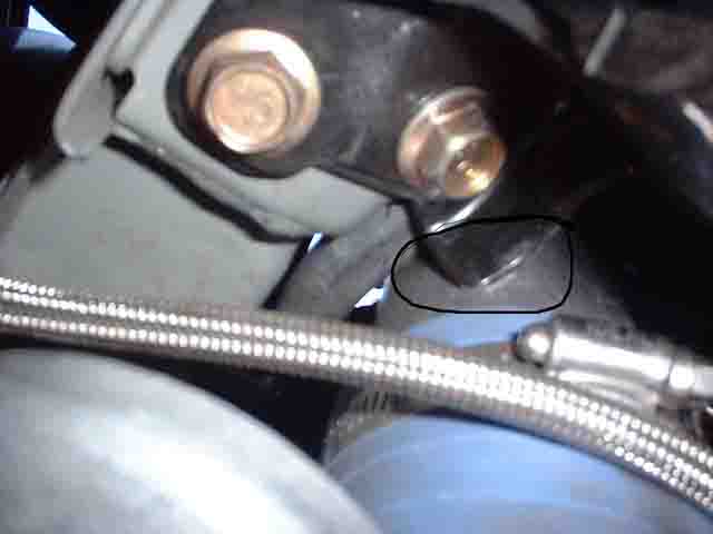

another pic
Attached Thumbnails Vortech problems owners beware-vortech-problems-005.jpg-1.jpg

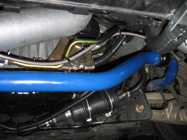

another pic
Attached Thumbnails Vortech problems owners beware-vortech-problems-006.jpg-1.jpg

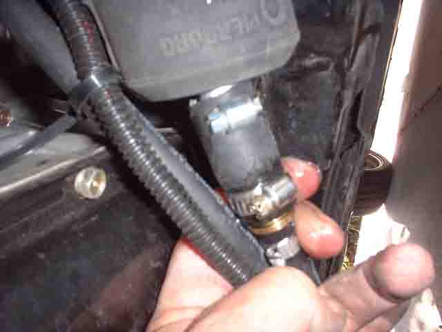

Sorry about your issues, but if you look at this pic:
You can see this was NOT something Vortech included in the kit, but something your installer HACKED out of a spare piece of tubing laying around by the mutilated looking cut.
Your installer needs to be blamed on that piece AT LEAST. No way Vortech did that.

Was it that length?
I'm not buying that Vortech would butcher cut a hose like that. Anybody that cuts hose regularly has a decent set of hose cutters that makes a clean cut. That just looks ghetto.

The short piece of fuel line does not look like high psi fuel injection line. High psi line should have metal braid internally not cloth braid as it appears. Make a reducer out of barbed brass fittings and proper line. What you show is a hack.
