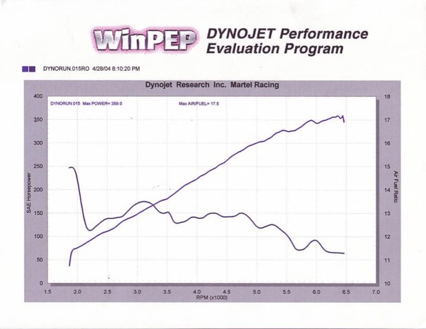

Had the G35 tuned (finally) last night. All runs done in 5th gear. 1st run (using vortech supplied R4 program) yielded 313 HP. Here are the results after about 12 runs of adjusting using R4 software. I am happy with it (for now) and power band is definitely is a lot smoother after tuning. Here you go...

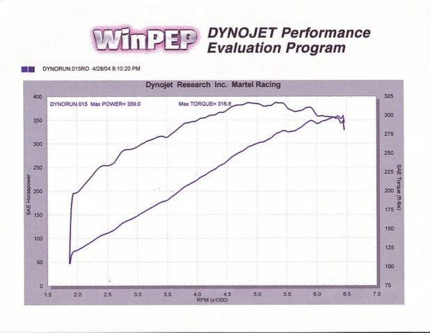

and another...

still seams fairly lean until 5500. Nice numbers

I'd richen that thing up or KABOOMMOO

I'd add a bit of fuel from 4000 to 5000 rpms but other than that it looks pretty good to me based on the amount of timing you are pulling.
