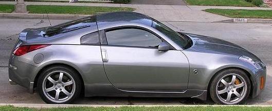

Attached Thumbnails N/A and F/I options?-350z-side-above-cropped.jpg

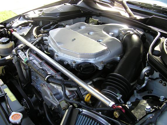

I can keep the crawford plenum w/ Greddt TT?
Here is my current set-up. I already have cams and clutch/flywheel
2003 Silverstone Track (NAV & all options except side airbags)
Competition wheels and tires: Nismo 5-spoke forged 18" x 18.5" front, 18" x 9.5" rear,
with Kuhmo Ecsta MX 245/40/18 front, 275/35/18 rear
Street wheels and tires: Stock Rays forged 18" Track wheels with Bridgestone Potenza S-03 Pole Position tires, 225/45/18 front, 255/45/18 rear
Nismo Limited Slip Differential
Tilton 8 lb. Flywheel
Tilton Rally Clutch
Tein Coil Overs with Electronic Damping Control
Nismo S-tune Swaybars
Crawford Strut Brace
TechnoSquare ECU - custom flash
Nismo R-tune C ams
Crawford Plenum
Borla Headers
UR Racing Pulleys
RT High-flow Cats
JWT Popcharger Intake
Borla Dual Cat-back Exhaust
Z-xtreme Grounding Kit
Drilled Titanium Pedals
Airbag Cut-off Switch (passenger side)
Attached Thumbnails N/A and F/I options?-crawford1-small.jpg

Yea the shop i talked to about the turbo install has fully built a motor on their project car with forged internals and dynoed 597 at the rear wheels with the greddy tt kit and the crawford plenum.
They actually told me they wont build my motor for TT without the crawford plenum as the factory plenum creates to lean of conditions in the # 5 and 6 cylinders.
the factory fuel system is their worst enemy right now and are currently designing a new fuel system to support up to 25 psi of boost and 650-700 hp!
Since you allready have the cams your motor is prime for some turbos and ready to take advantage of them .
plus with the solid LSD, high flow cats, and Clutch you can have a real 400 + whp monster with a simple turbo install!!
what are you waiting for!!!!?????
Looks to me like you could get the ecu reflash for F/I and loose the headers you can keep everything else!
