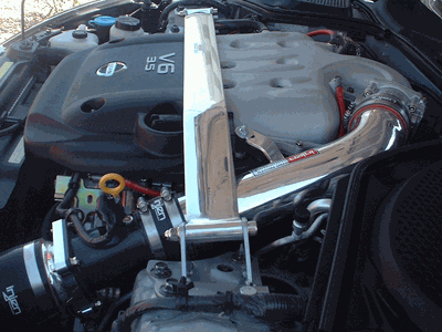

I ordered the crawford V5 plenum to deal with this problem as i will be going TT soon enough. I believe these Jic strut tower bars will fit over the crawford plenum.....I may be wrong however i think ive seen a pic of one on a car with the crawford!

oops looks like it wont fit.

Nope....no bars fit with the Crawford plenum, except for Crawfords
