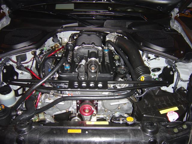

as far as the kinetix being able to handle boost, I believe kinetix has said no, they are developing a different one for fi.
as far as stb, here is an alternative that will work. it comes in unfinished stainless though, and has to be painted or chromed. I painted mine satin black. its the stillen one, and there is no reason it wont work with the crawford.

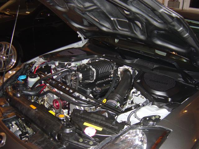

another view. its black, so hard to see.

whats that belt attached to the plenum.......

The Stillen Strut bar looks cool IMO. Why not a Crawford Plenum with the Stillen Strut bar?
Thats what I most likely will be doing.
Yeah, the Stillen bar does look better than the Crawford one, don't think anyone has done the crawford plenum with the stillen bar though.

the crawford bar wouldn't fit with the stillen s/c, so the stillen bar should fit with the crawford plenum with no problems.
