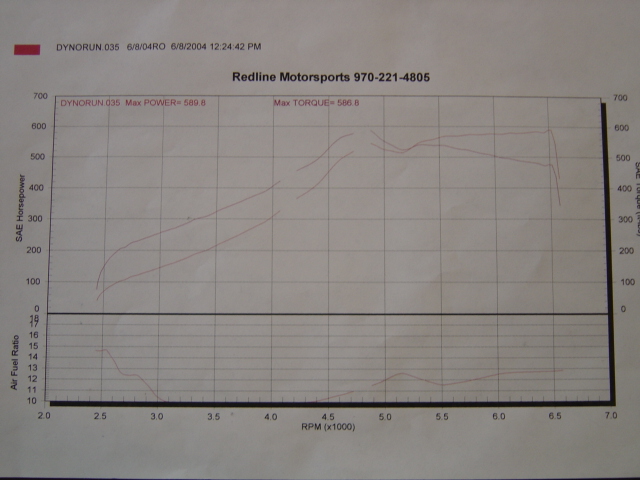

Here is our latest dyno chart!

icey2k1max i believe someone made that statement in a thread on our car. we have never made a statement to the effect that our numbers are uncorrected. i however do not believe the numbers are severely exaggerated. i have driven many fi cars at sea level and altitude and there is a difference in power. no matter where you live a correction factor is always going to be involved to a degree(temp, barometer, altitude, etc.). everyone has an opinion. in the future we can post the cf. we are here to share information not bragging rights. thanks jason

Looks like it is getting a little lean on the top end.

joenismo i agree that is about as lean as we want to go. that is at the top end of safe on a car with forged internals in our opinion. if it were a daily driver we would dial it down to 12 to 1. at this point the only way to richen up the top end is fuel pressure. and as you can see by the dyno we are already way rich in the middle. jason

So, that's ACTUALLY around 464whp/462wtq(using CF=1.27) and that makes more sense.
I knew squill was wrong before, just waiting for proof. Yes, posting the CF is a must ESPECIALLY for guys that are at extremes in altitude/temp.
Don't cheat...SAE correction is ONLY for NA guys and severely exaggerates the numbers the farther you get away from SAE base.

icey2k1max WE ARE NOT TRYING TO CHEAT as i said we have never posted our numbers were uncorrected. and i believe severely exaggerates is a bit extreme. anyway we will be posting dynos in the future with the cf listed. as stated earlier we are trying to share and learn information in regards to high performance modifications on the z.thanks jason.

I guess "cheat" was too strong a word, however correcting UPwards of 120+HP/100+TQ *IS* "severely exaggerated" IMO.
Why not just use uncorrected or post both graphs? Do you have the DynoJet Runviewer files? The whole point of SAE correction is to normalize the playing field(for NA though), however in boosted extreme altitude/temperature cases such as yours, it's doing the OPPOSITE, ie skewing the results away from the norm.

icey2k1max i agree with you that the cf is too high for extreme climates. however i do not think that a fi setup can overcome all variables as mentioned above. i have talked to many tuners in regards to the cf and they all have different opinions. i would be happy to post both dyno sheets or list the cf used on the day of the run in the future. thanks jason

It would be nice to be able to still correct for temperature and humidity on FI cars withOUT pressure. I wonder if the dyno operator could simply change the elevation to trick the dyno into thinking it was at sea level. Probably not since they have a baro sensor.

ICEY2K1MAX unfortunately dynojet dynos come "locked". it would be nice if they were adjustable, but that would leave the door wide open for dishonest tuners to adjust to their benefit. i am going to start a thread on cf's to get some other opinions. thanks jason
