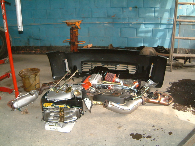

im sure ur sick of looking at my pics, so last one for now... plus my camera just died and i can't find power cord ... pile of stuff growing

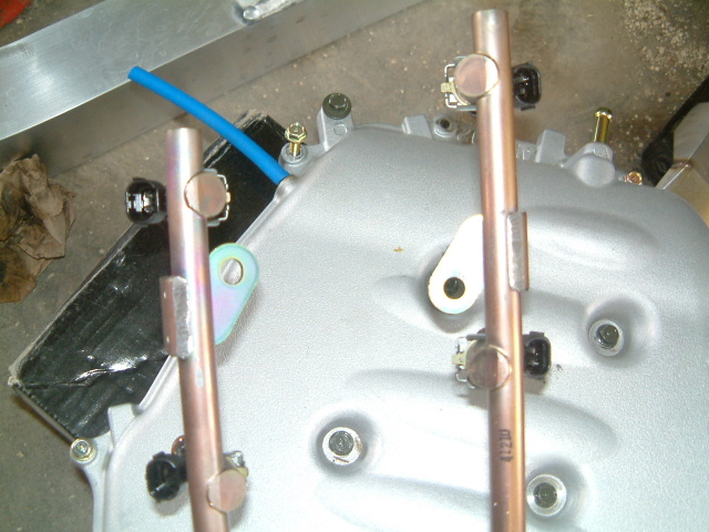

oops didnt put the fuel rail pic on...

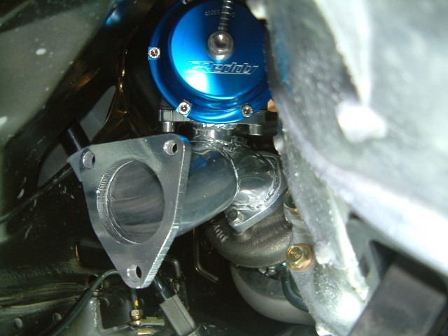

and forgot other downpipe... also lots of cussing

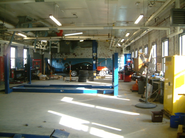

Pensacola? Are you at the guys shop that owns a black 350z?

as for a general comment. i cringe everytime i see how that wastegate dumps back into the downpipe.
No, its the Naval Base Whiting Field's Auto Hobby Shop.

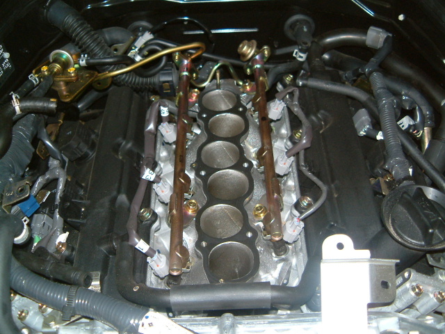

I know just enough about cars to make me dangerous, so I might be asking a stupid question. I am a little confused by your 3rd pic. That looks (almost) like an inline 6! The Z has a V6. Am I wrong? Please explain.

If you look at the injector placement you will see how each port on the lower intake goes left or right into the heads. If you had a direct shot you could see the intake valves.

here's a pic from ACP's install, you can see how every other runner goes to one side of the head...
why are you cringing... ?
Most street turbo external wastegates vent to the downpipe. Atmospheric dumps are usually used on the track, or by the really aggresive street racers like SkiDazzle. I guess it sounds like a 747 at takeoff.

It just hit me that pic #3 is of the intake not the cylinders with the heads removed. I'm such a dumb ***. Thanks for the other pic.
