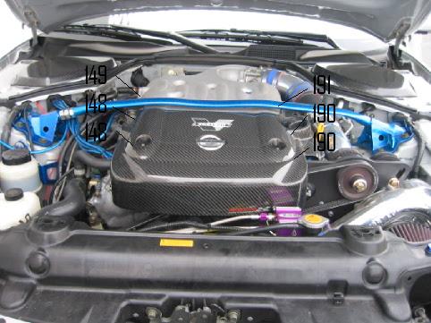

Well it looks like the worst that could happen did happen. I'm blowing past the whole left bank rings. thank you vortech. (really not i guess but i'm venting at the moment) it looks like i will have to get some intense motor work done. Questions: what should i get and from where? what should be the cost and does anyone know where i should go? (pref. PNW) this is not good at all. I thought that it might be the headgasket on that side but wouldn't you see a mixing of water and oil? because i'm not, so that might not be it, crappy news but i thought that i should share it. not that it will happen to you but more for FYI. here is the pic of the excact #s for each cylinder. let me know what you think
Attached Thumbnails Compression Test Done (Not Good At All!!)-z-compress.jpg

were you the one with excessive oil consumption, or were there other symptoms that prompted the check?
yeah that was me with the oil, plus the poor dyno #s

What you need to do next is a leak down test to find out exactly where or why you are down on compression on the right side. Seems awful fishy to me. I just don't understand why all your cylinders are equal and low at the same time on the right side.
yeah its super fishy that they are all the same on the right. but i was standing there when the test was being performed. and thats what i saw, i will look into the leak down test. thanks joe.

You need to verify the compression of each cylinder and write it down and post the numbers. START THERE. Pistons ring are not the only cause of low compression. A burnt valve is another. hard to believe that all 3 cylinters in the same back are low?
