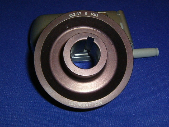

anyone know how to do the 'blower math' on this pulley, if 333 = 8 and 312 = 9, then 287 = ___?

Regarding your pulley question, seem to remember someone saying that the 2.87 pulley is 10lbs.

fyi::
hits 10lbs at 6K now........
