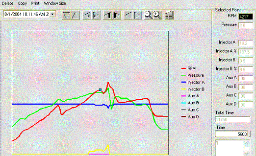

Well I went out today and after about 1 hour of testing I got the system to fail while I was logging data with the R4 software. Please see the attached for details.
I have a question: Does anyone know what the following mean / relate to in the SS software.
I got these figured out….
1. Over RPM = Turn on after this RPM is achieved. (mixed with AND / OR)
2. Fuel Pump start pressure psi = After this psi is achieved (mixed with AND / OR)
I have no clue about these...
3. Over Pressure = ?????
4. Fuel Pump run time = ?????
5. Over INJ % = ?????
6. Fuel Pump start time = ?????

Tommy, you might as well try it. BTW, where exactly on your R4 recording is it that the A/F spikes? It's hard to tell just by looking at the graph above.
--Steve
