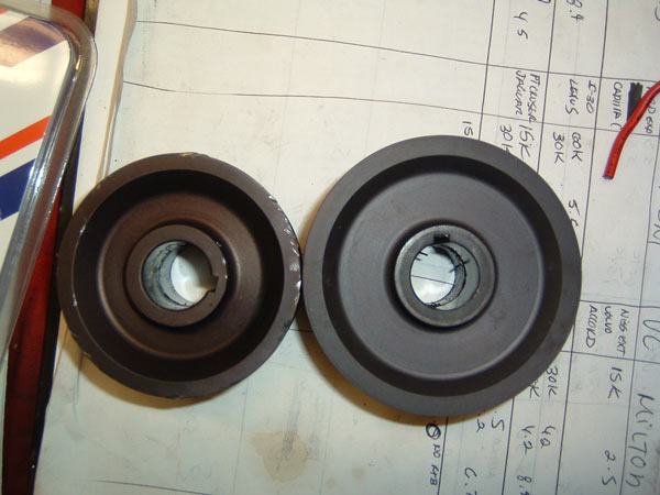

gotcha!!!
someone didnt have the correct cad values/file loaded to make this piece (me thinks)
heres the other image, for review........

NOTHER............
(NOW it makes good sense, eh?)
thnx for the clarification, boog..........

We made the 3.125 and the 3.33 thinner on the top and bottom end ribs for clearance issues on some of our Mustang systems. The 2.87 was never used in these systems, so we never changed these pulleys. If you want to use the 2.87 that we have, you will have to get the material on the top milled down. Or you could get a custom pulley made.
With all that said, it seems that there is a 2.87 on a car with no problems. Was there any modifications made to the pulley or the housing???

okay....
my findings.....
my 287 went on WITHOUT any machining whatsoever....
this "machining is a must" idea made no difference on my blower....
Boog- i think your jackshaft headbolts are stickin thru the bracket too far, and thas what rubbed..... make sure you have the washers on them ((non blower side))..
you might need to back em out a turn or two, or just add an additional washer to them. (YOU DO HAVE THE WASHERS ON EM, RIGHT)?
theres no clearance issues even close, other than that...... (by close i mean 5mm or so)
WTF would you be sold this part for, (i was told the 287 WOULD work fine) if it doesnt fit??
also, some pulleys coming with stamps on one side, the other side, no sides, and the newest:: no anodizing (makes me think theres other issues??)
i know the guys at V know their stuff, but wtf??
heres the 333 versus the 287

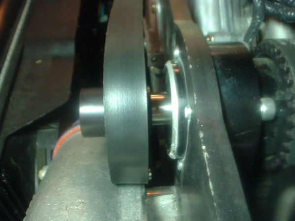

The car is not here right now so I cant check it . But Im sure it was not rubbing up against any of the bolts for the jackshaft assembly . Its rubbing against the assembly it self .And it scrapped the crap out of the jacksgaft assembly . Tomorrow I will take off the 3.12 pulley and take a pic . There has to be some thing different between my assembly and Esemes assembly or difference in pulleys . I would just like to find out why , so no one esle has to go through this . The pulleys look the same , so there must be some thing different in my assembly . ....Bill

OK...My girl friend is back with the car . I went out and looked at it, to see what could be the possible differences between mine and esemes [Scotts] . There can only be 3 things . [1] The stem on my pulley is shorter [2] The inside diameter [ look at my damaged 2.87 pulley ] is smaller [3] The out side diameter of the jackshaft assembly is bigger . I measured the stems on the 3.33 and the 2.87 and they are exactly the same . So we are left with the other 2 . By looking at jackshaft with the 3.12 on it now , I would guess its the assembly it self that is larger . IMO....Bill

okay, now i feel REALLY bad about recommending the 287 pulley to Boog....
WTF??? how did this work withOUT ANY fitment issues on mine??
time to bust out the micrometers fellas....
