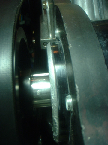

and lastly, notice the chew-job on the JS assembly...
im baffled...
truely....

you know what, i dont remember for sure, but i dont think my JS assembly stuck thru the bracket like that (if at all)...
hmmm....
we need Gspot35 to check in on this, and maybe mic' the 287 pulley and see what it measures....

I think Force needs to chime in here . I think I may just grind off enough of the JS to get the 2.87 to work .It has to be softer metal than the pulley its self , as by the damage to the JS and just scrapping off the anodize of the pulley [dont know] .I will get it to work one way or the other . I just need to find out the best way to get it done . ....Thanks...Scott...you've been a great help....Bill

one thing you DONT wanna do is run a pulley that is no longer balanced....
by scraping at the surface like you did, its possible (albeit not much) that you have 'unweighted a portion of it, and will now have a slight wobble introduced...
this could be bad, if multiplied by, say 50K or so (60K really)....
lets hear from steve!!
ese
ps- maybe a machine shope could groove the pulley for you, using a lathe, and then drill any holes in it to balance it back out....

If you could look at it up close you would see that it just scrapped off the anodize , no big deal and I dont think it put it out of balance .{ Ithought of that too ] Thats why I think grinding off the JS assembly would work out best . I got to find out how thick that JS housing is first . I dont believe it will take much more to get it to work , as its already been ground off alot . I understand that Vortech has to be careful of what they say . But I still want to know why you got it to work and it didnt for me . [1] they gave you a different pulley than me . [2] Our JS assembly's are different , either way I want to know . Bill

Its looks to me like the Jack Shaft Housing needs to be machined down. The material protruding thru the blower Mounting Plate. That jack shaft housing was not designed to fit smaller that a 3.12 dia pulley (But it could be) I would need to have a 2.87 dia pulley, But it looks like removing about .090 in with a

heavy chamfer would do it.
Anybodys thoughts?????

That was my thoughts , I still got to get a hold of Steve at Vortech to make sure it's safe to do that . He wasnt working yesterday . Still confused as why esemes got it on and working . That jackshaft housing on his has to be different...Didnt get any pic...gspot...but thx........Bill

Im am going to measure the diamiter of the jackshaft housing and how far it sticks out . If any one has there serp pulley off , could you measure it too , so we can find out if there are differences for one kit to the other ? Or even better yet ...take a pic of the housing with the pulley off and post it so we can compare my housing and others . Hey Gspot if you go to the 2.87...would you take a pic of the housing with the pulley off .As we know that the 2.87 has worked with your jackshaft housing ?Let see if we can find out , Im sure there are others that want to go to the smaller pulley , but are now wondering if it will work or not .We can save others time and money....thx...Bill

I got the pulley milled and will try to install in a few days .When I get the time . Doing some other things to it right now . No big hurry as I need to call and make a dyno time to tune any way.I will let you know then....thx for your input...Bill
