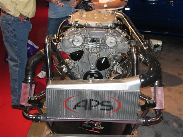

pic 1

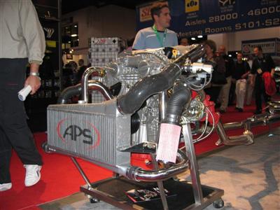

pic 2

Oooo very purdy Someone should photochop the second pic with the words... "Ph3@R M3!". Thanks for sharing the pics, you a lucky bastid (j/king) to be able to go to SEMA.

i love that intercooler, its so original. Why do they use that coil looking tubes that connect the filter to the compressor? Why not hard pipes? Arn't they going to bounce around everywhere? And also wheres the MAF?

The hoses are actually a specific part that that is very tough and allows for a great deal of flexibility (the engine moves a fair way when under torque) and the air cleaners are firmly mounted on the body. The hoses themselves are not visible.
The MAF is located on the stainless steel duct to the throttle body - just above the blow off valve in the picture below.
Hope this helps.
