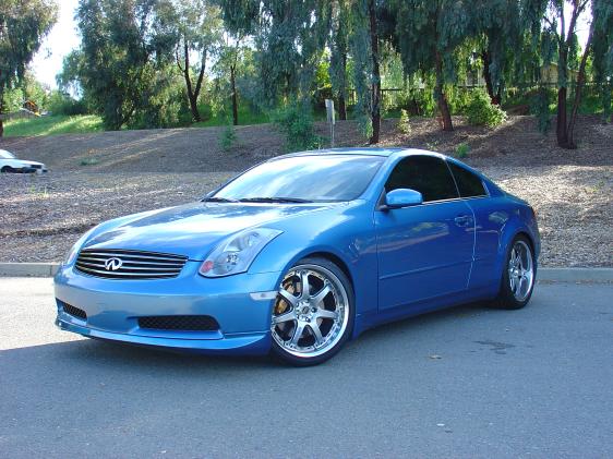

Heres mine car with eibachs (first pic) and with Tein H techs for a Z.(second pic)
Attached Thumbnails 350z Tein Hs on my coupe.  How much lower?-228012-tomting-s-20g35c.jpg

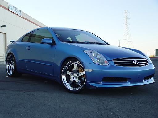

Now the Tein's
Attached Thumbnails 350z Tein Hs on my coupe.  How much lower?-picture-121.jpg
