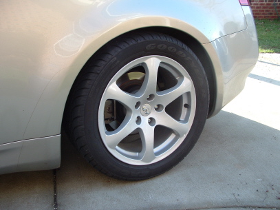

What are the benefits? Does it lower the G coupe any? How is the ride? Is it much rougher? Anything else that changes? I would like to lower my car just a bit and not have to spend much $$$. Any input would be appreciated.

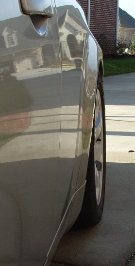

i did & I really didn't notice any difference. Probably about 1/4".
I then cut the rear bump stops about 3/4" & really liked the final height.
Also remember that things like how much gas you have will effect the ride height. Even your weight will effect the height.
