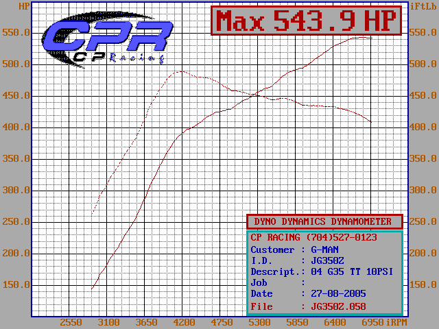

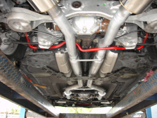

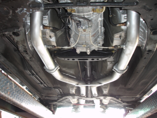

Car is tuned and I got a new 3" true dual exhaust. The body kit is not installed yet.

Nice torque/power curves.

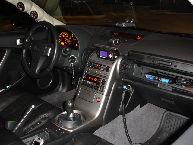

Couple of questions:
1. 3" exhaust custom made?
2. Sways......no trouble with contacting the new exhaust, or was the exhaust custom built to avoid that issue.

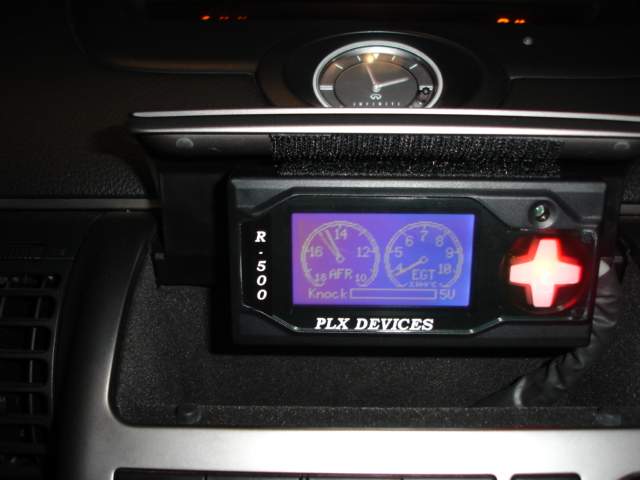

3. Gauges/sensors......where did you end up mounting them.

1. yes custom 3" true dual with HKS TI mufflers
2. no problem with sways as exhaust is custom
3. Fuel pressure, boost, and AEM wideband are in a gauge pod. The PLX R-500 is on the door of the navi compartment. PLX give me another wideband, EGT, and knock amp. The AEM sensor is on the passenger bank and the PLX is on the driver's bank.
