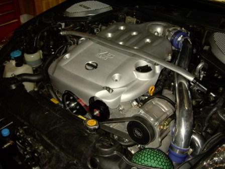

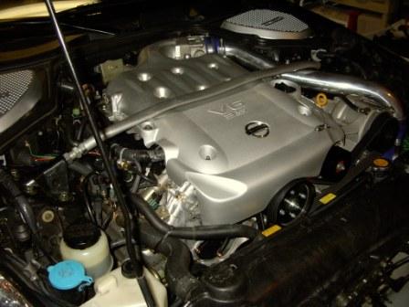

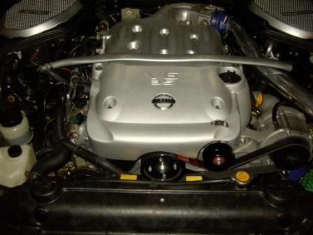

Originally Posted by Ed 718
I'd like to see it if you don't mind I'm thinking of something similar
here you go:
Attached Thumbnails Anyone paint their Plenum?-resize13.jpg   Anyone paint their Plenum?-resize14.jpg   Anyone paint their Plenum?-resize15.jpg
Old Feb 22, 2006 | 11:21 PM
Ed 718's Avatar
Ed 718
BRAVEHEART
iTrader: (32)
Posts: 8,830
From: PRODUCT OF BROOKLYN 718 USA
I like that what paint was used ...info please or PM me thanks
Old Feb 22, 2006 | 11:57 PM
Z BOY's Avatar
Z BOY
iTrader: (41)
Posts: 5,264
From: CA
just for you, ed, i just went to my garage 3 flights down to get the can. I was wrong. the vht i used on my stock exhaust to clean it up, when i had it on my car. It had a temp tolerance of like 1500`F. On my plenum, i used "dupli-color engine enamel with ceramic, heat tested to 500`F". Color is aluminum, #DE1615. The stock plenum tends to get grimey over time, so i scrubbed the exterior clean w/ a degreaser and put a few coats of this paint on it. Shined it up real nice and gives it a more glossy color than stock.
