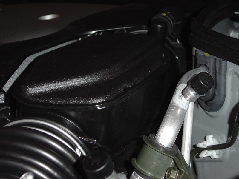

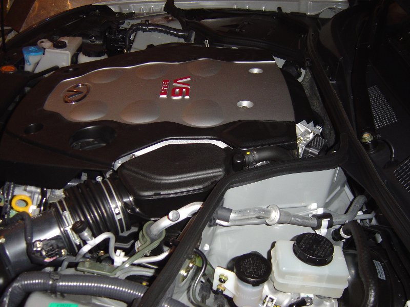

Only problem I see is this thing in the middle of the stock intake tube - has some sort of piping out the bottom. May have to toss the cover (no loss), watch the hood clearance, too - tight.
Only function I have heard for this box halfway up the intake is some sort of resonator or sound dampening box, just hearsay, no idea what it really is for.

Yeah that thing is worthless, I just put my Z-tube in today it fits perfectly. So like I said, any 350Z intake will work with a G35, if you go CAI there is a resonater below the stock airbox you'd need to remove.
thanks, my Z did not have anything like that so I was scratching my head figuring out why they would put anything in the middle of an intake
