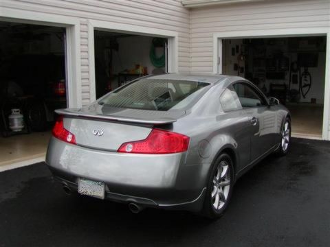

A pic of the 275/40/18 PZero Nero M+S tires on the OEM G35 Coupe wheels (18 x 8JJ + 30mm offset).

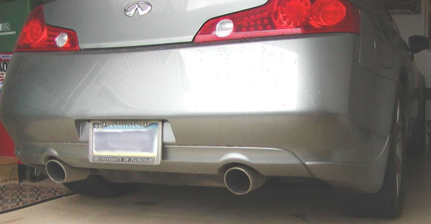

Default 275/40/18 PZeros from the rear
Originally posted by FIRESTARTER
Do you have a closer pics of youre tire set up?
I shot some pictures in the garage, but they aren't great--for 3 days now it seems like it's been raining everytime I try to go out and shoot pics.

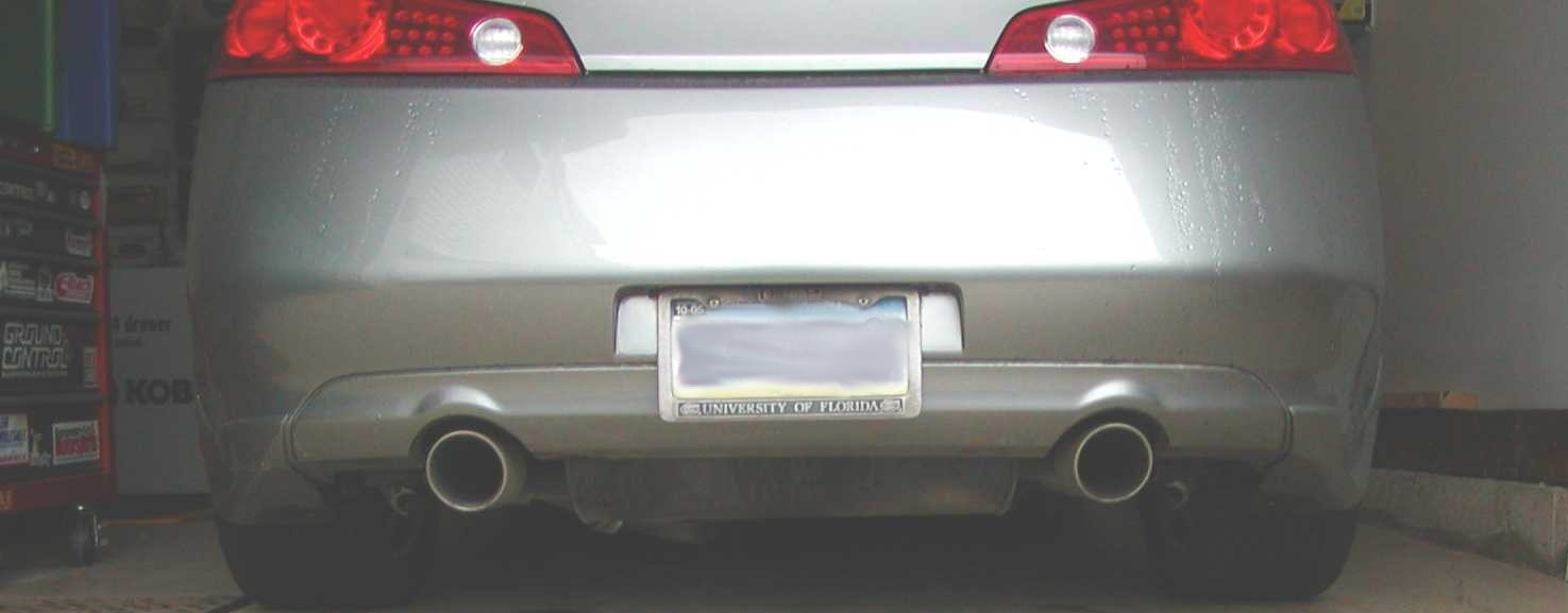

Default 275/40/18 PZeros from an angle
Again, sorry the lighting wasn't too great.

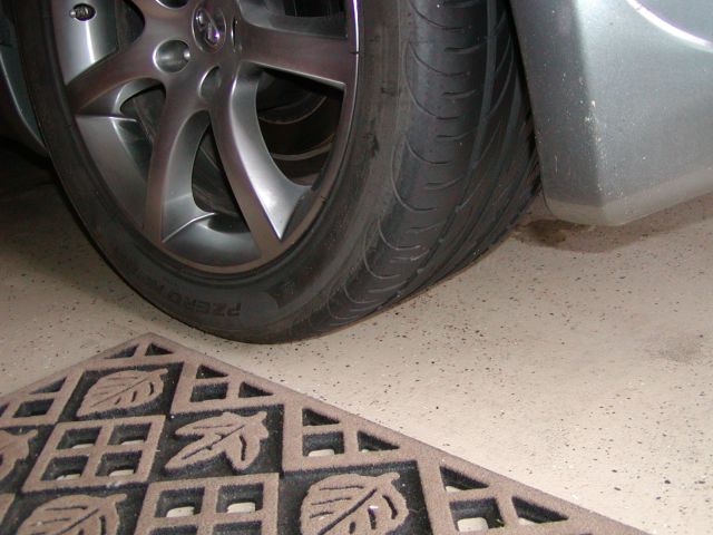

A shot of the tire.

Default 275/40/18 PZero from an angle
For a tire with a 10.8 inch section width it doesn't look too wide in this pic.
