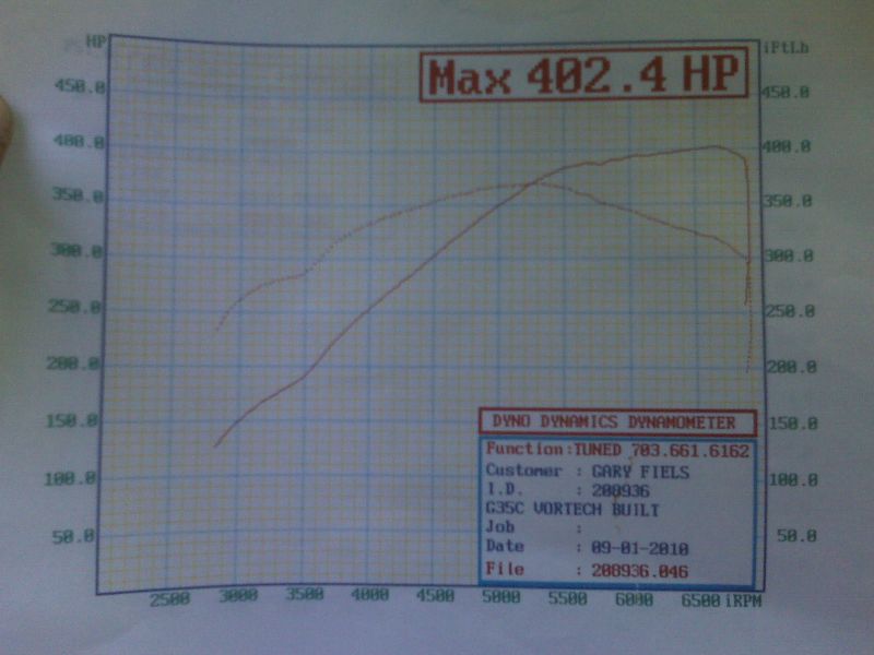

Whats going on guys, I just wanted to share my Vortech numbers from Function Tuned. I previously blew my built engine at just over 4k miles spinning my bearings; I blame the non rev up oil pump for that; anyway, I ended up going with another built block and ditched the ss box. Dave suggested we go with Osiris as it would help the car operate more like stock. After a couple hours of tuning on a DD, I managed to make just over 400whp and 370wtq. I am very happy with my numbers and Dave tells me there is more to be made, just need to upgrade the intercooler and/or bumper. It’s my understanding that a dynojet would read higher putting my numbers at 440 or 450ish…

Isn't SC supposed to built tq all the way to max power? Just curious why the tq drops off like a turbo.

builds hp to max. torque will always drop off in a car because the faster the crank is moving the less tq is placed on it.....well, that was kind of a crappy way of putting it but that's the best i can put it to words. someone else?

I was looking over my boost curve and it plateaus at around 10 pounds across 1k rpm from 5k to 6k. Above 6k it keeps increasing until it hits just over 12lbs. I thought it meant my belt was slipping but I didnt hear a squeal. Is that typical?

belts squealing is SEVERE belt slip. Belts slip long before it makes noise. You shoudl NEVER have a flat spot in a boost curve on a supercharger. Every rpm that engine goes up the boost will go up. It's directly tied to rpm of the motor through that pulley.
Pulley's add about 2lbs per size so if you were 9.5lbs on 3.12 then you should be at 11.5 on the 2.87 stock impeller. The 928 impeller has shown quite a bit higher boost levels than that. You're 3lbs down from what my car was doing on a stock 2.87 pulley. That's just weird. The flat spot on your boost curve would mean belt slip or boost leak somewhere.

the flat spot in the boost is still an oddity.

If I could call it based on the dyno plot I'd say you're slipping above 5.5k. That could also explain the lower than usual peak boost and HP.

Thanks for the input guys, my hp curve seems to be flattening out right after 5200rpm or so. Im thinking this has to be the belt slipping as well. I have the GTM pulley mod so hopefully all I have to do is tighten the belt with the tensioner.
