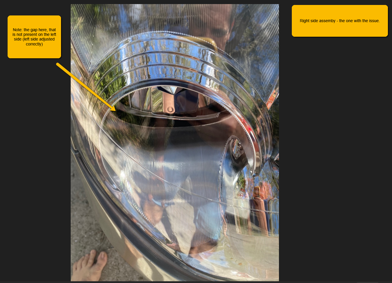

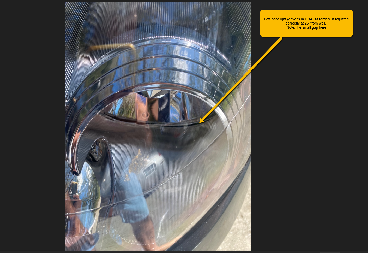

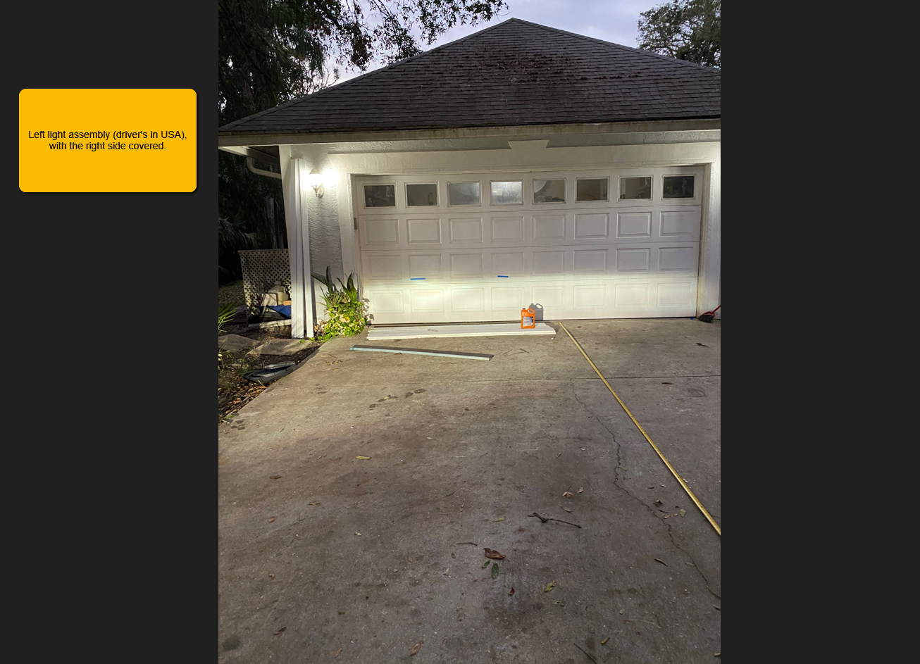

UPDATE:
So I managed to get the thing highlighted in red off (Previous post).
and get a ratchet on to the hex head (it is 8MM not 6MM) and nothing is moving.
I managed to get the seller to send me a replacement passenger assembly and we'll see how that goes.
Here are some of the things I noticed comparing left and right assemblies Both lights uncovered
Right light covered
Right light covered
left side - no gap
left side - no gap
Left light covered
Left light covered
right side - large gap

Likes: 26
From: Sarasota
Update: I got the replacement right side assembly and tried the gizmo that is used to adjust the bulb's beam and it just clicked. Used a 8MM socket to adjust the beam off the car to be near what I had on the left side.
Put the assembly in the car and finalized the beam adjustment using the 8MM socket .
All good now.
