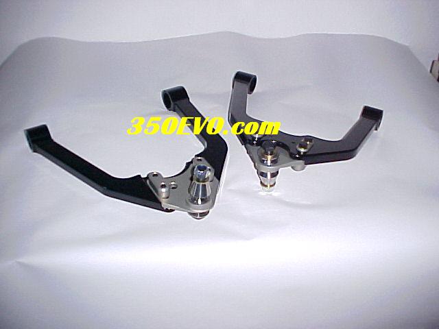

350EVO front control arms.....

There is no camber adjustment on the Z or G35's on the front end. The rear there is but it is very limited.
Our front arms allow for easy adjsutment on the front end and our rear kit will be out shortly.
Our arms are the same ones we race with in the Grand AM Cup Endurance series........
350EVO designed, developed , tested and proven through motorsports.
Cheers
$850!
