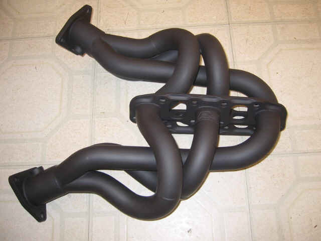

Just took a pic of mine. DC stainless steel headers with Jet Hot 2000, black coating.

Here's a pic of the DC stainless next to my other set of DC ceramic:
The ceramic are a bit dirty since they were used, but this gives you an idea of how they all look. I have to admit it was tough to cover up that great polished finish.
