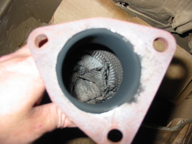

Can any who have had the RT Cats fail describe the difference in exhaust sound? I am trying to seeif this is my issue now.
Thanks.
~ KZ
Old Apr 24, 2006 | 08:53 AM
tonio's Avatar
tonio
Posts: 549
From: atlanta
The exhaust sounds very mumbled and there is a noticeable difference in a loss of power.. its not a good thing because it causes a lot of backpressure that could damage your engine.
Old Apr 24, 2006 | 08:56 AM
kzanard's Avatar
kzanard
Posts: 145
From: Boston area
Thanks Tonio. I have done some more searching and found other threads. it sounds like what I am experiencing may be the R/T's collapsing.
I have a set of Crawfords sitting at home I bought last year & never put on so I am going to try and find a shop to switch them out this week to see if that does the trick.
You will more than likely need to re-tune your car after you put on the Crawford cats . Your gonna gain some boost because they are more restrictive . I gained 1.5psi when I switched
Thanks Booger, that's what I thought anyway. I plan a tune after any intake or exhaust mod. I had Crawfords on a long time ago and I remembered that they were more restrictive. I think they were a little quieter than the R/T's too which is a plus. I just hope it is the cats that are causing my current woes and not something else. I will update after I have them changed out.

Mine collapsed when I was at the track .Thought I had broke something inside the motor . You will be able to tell once you get them off . The metal inside pushes out in the middle and the reast collapses down and plugs up the exhaust ....good luck

Mine failed after 6 days and it felt like a 4 banger. then went into limp mode

Just got a call from the shop. The passenger side cat is collapsed. Now the problem is they are telling me there is not enough room on the Crawfords to weld a bung for the wideband before the cat! I am pretty sure my old Crawfods had the bung there.

It was the cats - whew! The Crawfords are in and sound is back to normal. Here is the culprit...
