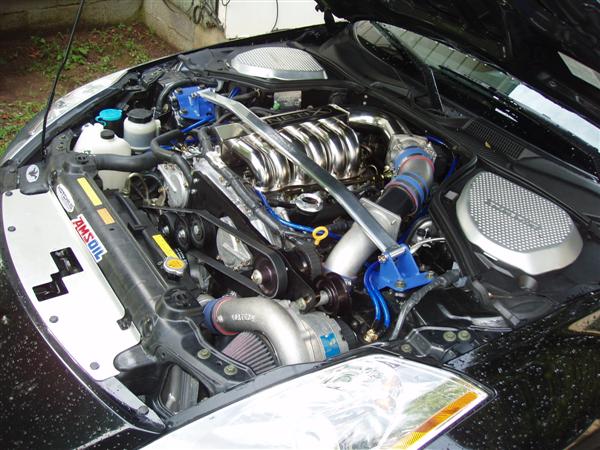

There is absolutely NOTHING wrong with the "PLASTIC ONE" as you call it. The Kinetix V4 plenum will allow you to keep your OEM strut bar. It will not break or whatever you are afraid of. Older versions will but to my knowledge there have been ZERO reports of the V4 cracking or breaking. I had it my car for about 10k miles with numerous AutoXs, drag runs and high speeds runs and it never failed.
You can get the Crawford or the APS plenum, but they both require that you replace your strut bar. Plus, they dont look as good as the Kinetix one.
Or... you could get the new Kinetix intake manifold, which I am currently running. It replaces the OEM upper and lower portions of the upper half(yes, its 3 pieces) of the stock intake manifold system. This one will allow retention of the OEM strut bar and it looks bada$$.
The pix below are both from my car at different points in its life!
Attached Thumbnails What PLENUM to buy?  will it work with Stock Sway?-zachs-car-003-custom-.jpg   What PLENUM to buy?  will it work with Stock Sway?-v4-kinetix-plenum-2.jpg
