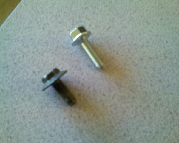

Originally Posted by mc350z
my 2003 Z OEM strut bar bolts are 12mm. is that what they all are?
my car was built in july of 2002 so i guess i need to run to the harware store and pickup some M8 30 mm bolts?
12mm at the head is OK, but it is the threaded shaft that counts. I suggest waiting for your kit to come in and try one of the bolts to check it first.
ok mine is installed
the M10 strut bolts dont fit. so i had to use the stock ones with the spacers (for now) i didnt use the washers so ive got about half the bolt threaded through.
TONY a few quick questions. do i need to rush out and get longer bolts? or will the OEM ones still be ok? im not trying to sheer a bolt off.
what are they M8 30 mm? whats the thread?
also clearence wise i can fit the packet of instructions under the strut, thats about it! i would add the washers but my hood is so borderline
but i ran it up to redline a few times and didnt hear anything. but its too close to the plenum to see if there is any scratches or rubbing marks.
by the way i can tell an instant difference. the sound is alot deeper. but somehow the "chirp" intake sound of my nismo CAI is gone! its masked by a deeper sound. so with the nismo Exaust my car really has a more unique sound.
so thank you. you make a quality product!!!!!!!!!!!!!!
Thank you!
As for the stock bolts, you will be fine assuming you have 3/16" or more thread to screw it into. And for the bolt specs, you could do me a big favor by taking one of your stock bolts and taking it to a hardware store and matching it up against another bolt of known dimensions and let me know what they are.
I have tried to get this information for a long time, but its rare to find this bolt in domestic Z's. There were a few Canadian and Australian Z's that had the different bolt, but they werent able to say what the bolt specs were.
Please let me know if you find out.
Tony

OK. It sounds like you have the M8 bolts. And yes, that is consistant with the 2002 year.
And your clearance is fine as long as the plenum and STB dont touch. If they did, you would notice it as a buzzing sound. If you don't have that, then you are perfectly good to go.
ok tony here are the specs.
the bolts that come on the 2002 Z's are M8 20mm 1.25 thread. they need to be replaced with a M8 30mm.
Awesome! Thanks for the info. I've been looking for that thread pitch number for a while.
Tony
