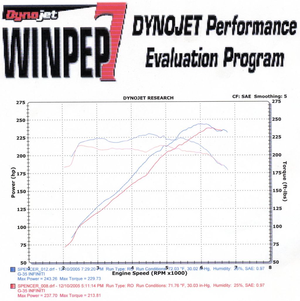

Default One more dyno
Here is another set of dyno plots by Spencer over on the G35 driver board. Pre/Post dynos were taken without removing the car from the dyno.
Comments by 13bmx5 (Spencer):
The runs were made in 4th gear and they were "best ofs". The other runs were within a few hp or the torque numbers did not read properly. I did the install on the dyno, the car was never unstrapped. I did not do an ecu reset. My pulls were made to 7k on the tach inside the car, I did not let it hit the rev limiter. The only way the dyno will read 7k is if you let the tach read 7.3 to 7.5ish.
Area under the TQ curve says it all...
Attached Thumbnails Another MREV PLUS dyno ~22HP and 26 TQ-spencers-mrev-dyno.jpg

The power band will have a little squiggle to it but in any case, HP and TQ will be shifted up as shown in the above plots.
