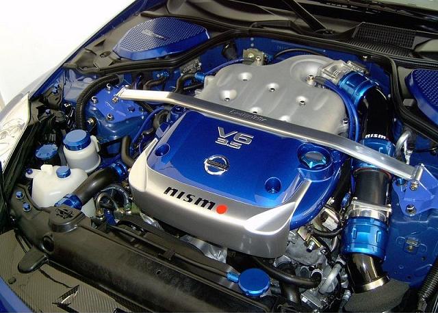

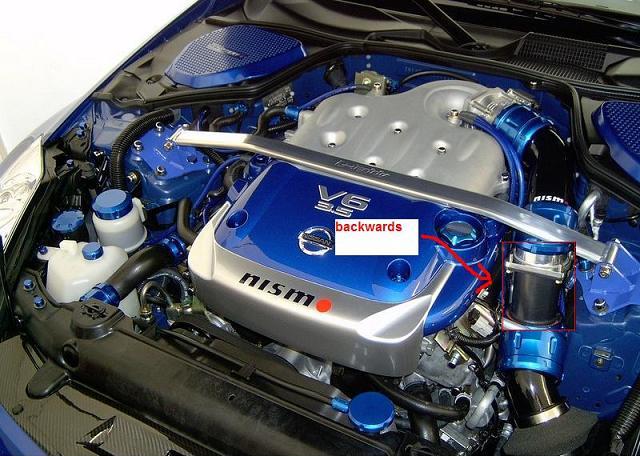

heres what he did
first one normal
second fliped. or backwards

Yep thats it. I'm gonna flip it around after I get out of class. Which should be around 11am eastern time. Wish me some luck.

Originally Posted by YBLegal
heres what he did
first one normal
LOL....that's one hell of a photoshop job! Well, you learn something new everyday.
