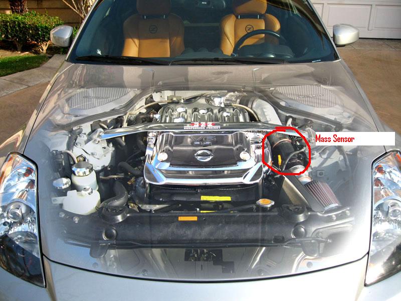

you have the mass sensor backwards..

this is mass sensor
If all your plugs were plugged in then def. check that.

yeah its definitely a mass air problem, there isn't much you can do installing a cold air except that

But why does the engine bog down at 2.5k rpm? When you say backwards, do you mean the plug is on backwards? Cause there is a notch that prevents that from happening. If you guys have any more ideas please dont hesitate to let me know. I really want to drive the Z.
+1
But no reason to remove the MAF from the housing ...
Mass sensor reads how much air, temperture, and quilty of air thats coming.
so if you have it backwards then its not reading correctly so it wants to kill the engine so no harm is done to the engine.
now as far as backward.. meaning the WHOLE thing not just the plug.
just go ahead and flip the whole housing look at the pics above.
Then see what happens.. no reason to reset the CPU it lears by it self
