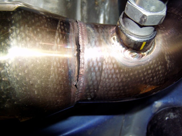

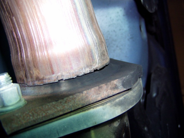

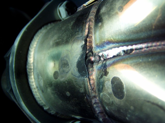

From my experience, go with hangers. I learned the hard way with cracked TPs, Y-pipe and B pipe.
I had Megan resonated TP and they had a small piece of weld left over in them or something like it and rattled like crazy. They also didn't have hangers. It got quite expensive to fix it.
