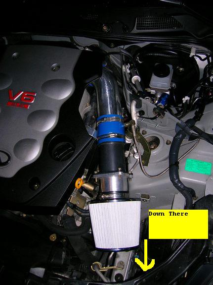

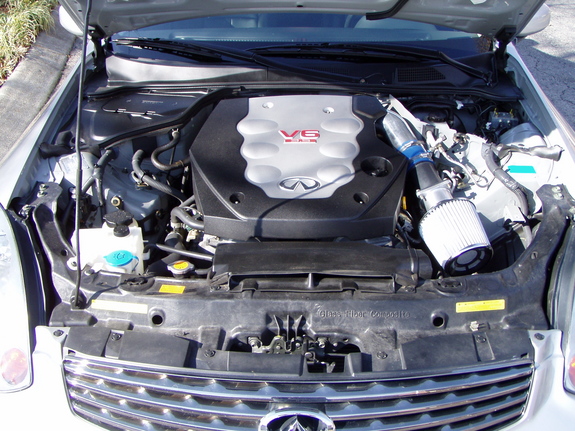

I have the shorty on it for now, because i couldn't figure out how to postion it to fit the air filter and the tube down the little opening down there.
- Did you guys have to modify the "foam like stuff" inside the bumper or did it just fit down there some how?
- And do you have to cover the filter when it is down there, because of rain....etc.
thanks

You will probrably have to take the bumper off to fit the complete kit on. I have a Z so I'm not sure about the fitment/clearance on the G. You don't have to cover the filter but to be safe you could get a bypass valve in case you do go through a deep puddle.

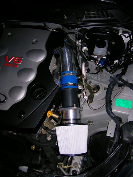

another pic

yeah I used to have the AEM CAI and when I took it off I had to remove the front bumper. You may have to do the same. It's not hard.

dont remove the bumper its not the same as a z,all you have to do is remove l/f wheel a few bolts and the inner fender panel will move enough to get to the filter and install(clean)and yes you have to get rid of the foam on that side.its actually pretty easy.
