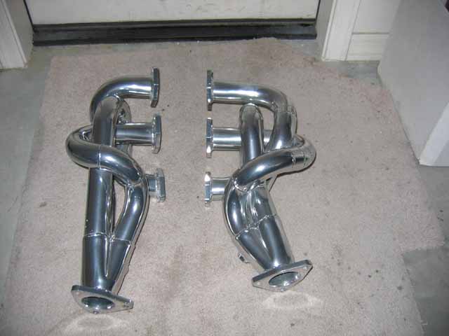

They are not Nismo replicas - Look at the collector. The Strups are like most other inexpensive header out there, three smaller pipes merging into a larger pipe that the manufacturer calls the collector. The Nismo and the Crawford have true collectors. The Crawford is a long tube design. And YES, they make a hellofa difference. I Love mine, They are HetHot coated.
Lou

Actually the question is for you. Figure $450 for headers plus $300 install or $750 for about 5 horsepower. Some consider the expense worthwhile - others do not.
Also keep in mind the the entire exhaust system is only as efficient as its least efficient component. The photo above does not show the OEM exhaust manifold well (on the floor). But if you took it off and looked inside, its a wonder any air gets out of the damn thing.
