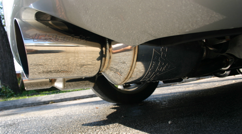

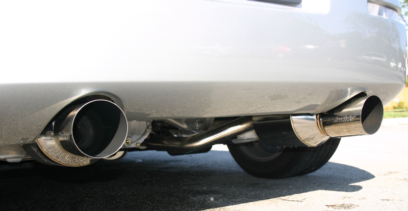

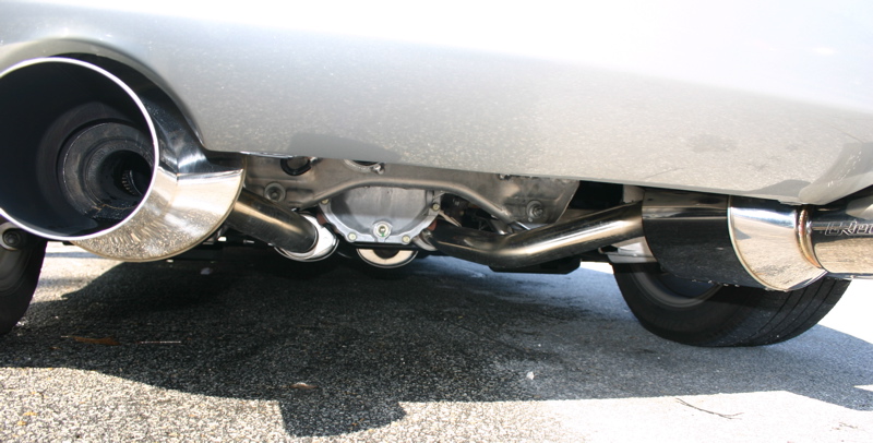

The install is not bad at all... everything is bolt on... the exhaust system comes with all necessary items for an easy install. The relocation of the EVAP canister is the most difficult part of the install, but with a little patience, it is still easy. I ended up purchasing some aditional heat shield sleeves to cover all three hoses that connect to the canister. Reason being, the hoses are really close to the pipes.
