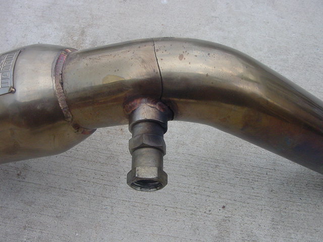

As mentioned above pick up 2 sets of non-foulers (spark plug). Drill one set out with a 1/2" drill bit and leave the other set as is. Screw the non drilled set into the test pipe. I suggest screwing your o2 sensor into the drilled set before screwing them into the non drilled set already in the pipes. The sensor is a pretty tight fit and when trying to torque them you'll risk breaking the drilled non foulers in half (did it on mine) if they're already installed. Hope that made sense... Anyway, it should look like this (disregard the crack in mine ).
