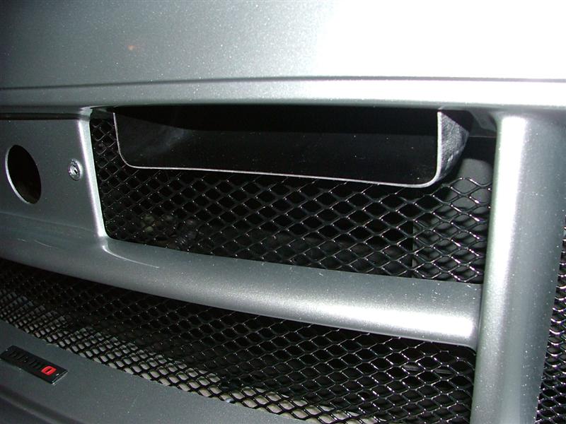

im getting the nismo v2 front bumper and to what i understand it has an intake scoop...since there are no affordable cold air boxes...i figured i would put my stock intake housing with a high flow filter.......of course im trying to keep hot air out..
....what do you guys think?

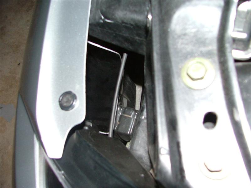

um, why not leave it? The v2 bumper should convert your poopcharger to a cai. It has a duct the pushes air to the hole in the front where the varis air duct feeds.
They should be compatible.

op, the duct and heat shield on the POPcharger will bring in cold air. The v2 duct goes in the front opening and funnels in COLD air to your POPcharger.

ok the v2 scoop brings in cold air-great
the pop charger heat shield is worth crap and lets all the warm air in-bad
now in almost all the professionally modified Z's ive seen that they keep the factory air box.....so my question is....take the popcharger out? or will the v2 air scoop balance it out?

Stillen has. I dont get it. I know the pop charger draws hot air from the engine bay but wouldnt the duct draw cold air in? Isnt that why people get the Varis air duct with the pop charger for the CAI effect?
