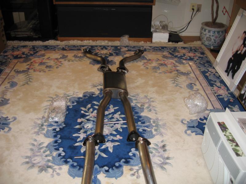

Old Oct 28, 2006 | 09:30 PM
dragonbz99's Avatar
dragonbz99
Posts: 220
From: new jersey
pics....

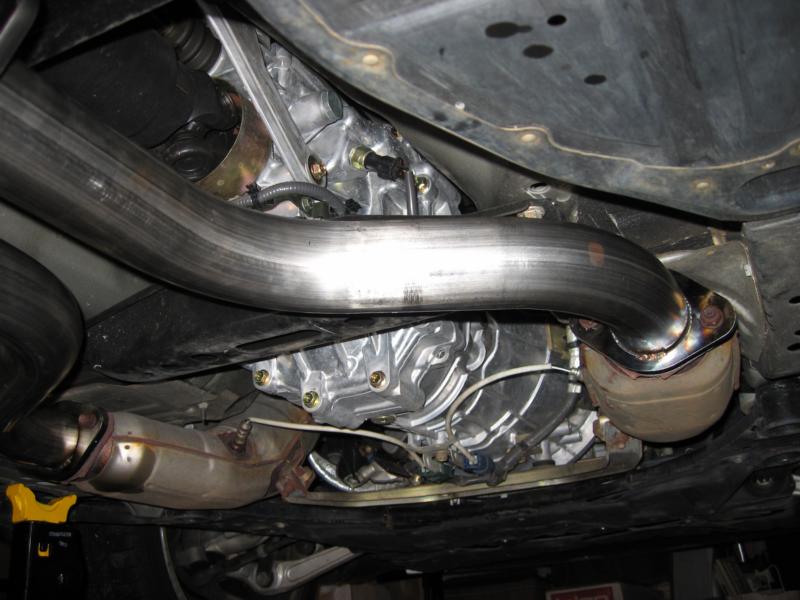

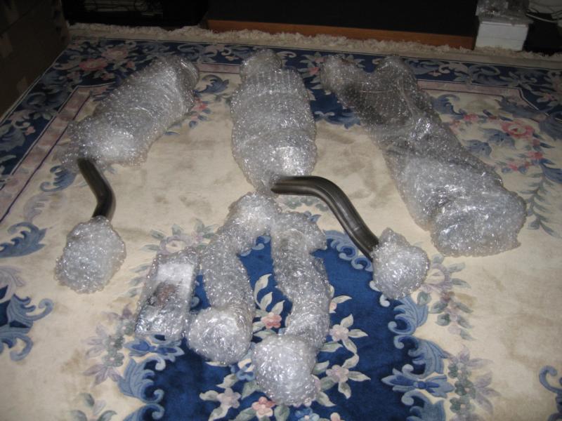

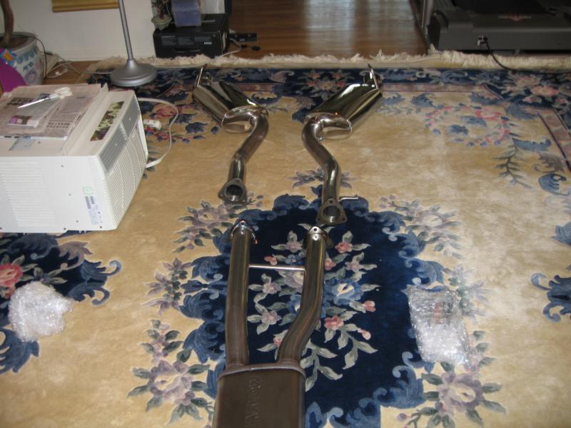

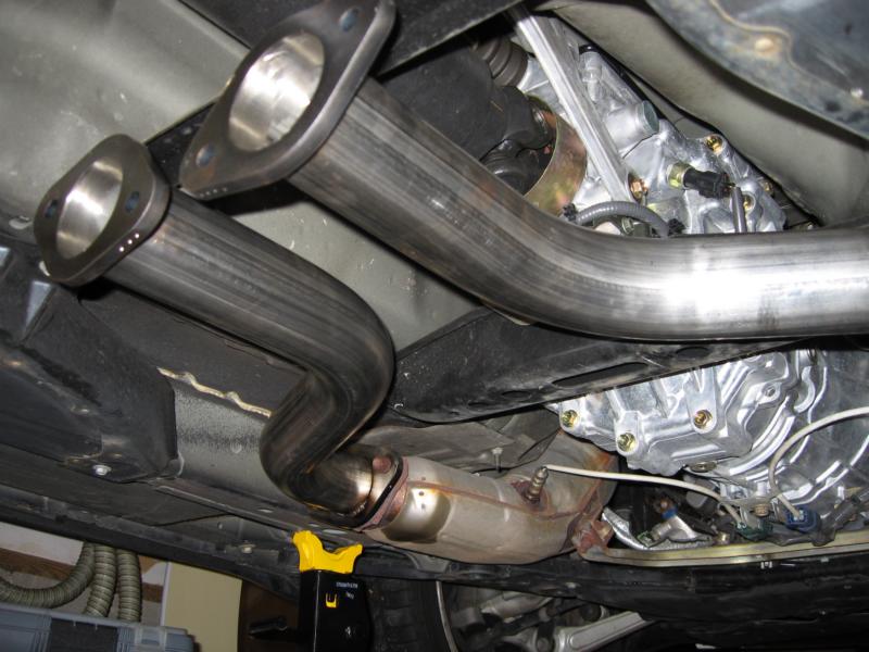

Attached Thumbnails intimidator is here-img_7356_m.jpg   intimidator is here-img_7357_m.jpg   intimidator is here-img_7359_m.jpg   intimidator is here-img_7360_m.jpg   intimidator is here-img_7361_m.jpg
Old Oct 28, 2006 | 09:31 PM
dragonbz99's Avatar
dragonbz99
Posts: 220
From: new jersey

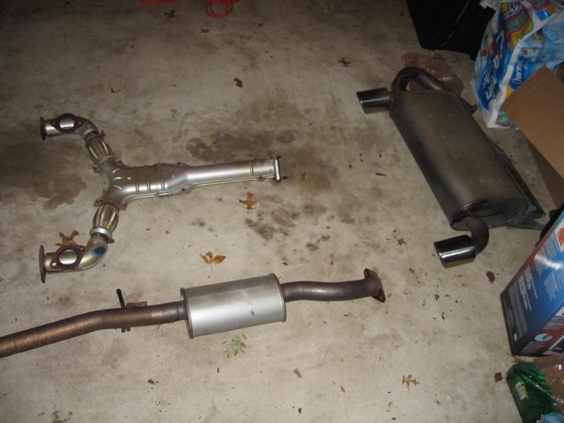

more pics...
this is as far as me and my friends got. couldn't get the xpipe to fit wihtout getting the crossmember out of the way.
Attached Thumbnails intimidator is here-img_7363_m.jpg   intimidator is here-img_7362_m.jpg

What do you mean by the "crossmember" is in the way. The pictures you're showing are that off the transmission mount.

yea, i took those pictures before i tried to get the X pipe through. those pipes are the ones from cat to xpipe. the x pipe has to fit through the cross member which is near the middle of the car, but it seems the frame is blocking where the flanges need to fit through, if you drop the crossmember, the xpipe will fit.
if you look here
http://www.fastintentions.com/images...50z_under3.JPG
at thetop, the black cross member right beneath the xpipe.

theres no way to get it through, you need to at least move the front 4 bolts to drop it down a bit.

oh yes...the four bolts have to be removed so that you can pull down the x-member just far enough to pass the magnaflow resonator past it. There is no other way...I just did this install two weeks ago. The flanges of the piping rubs into the transmission tunnel.
