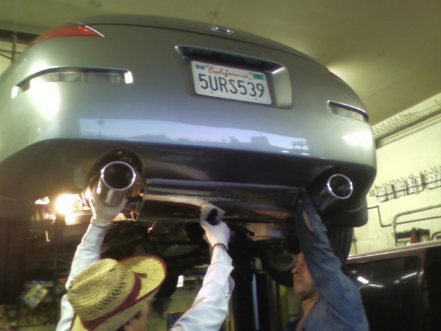

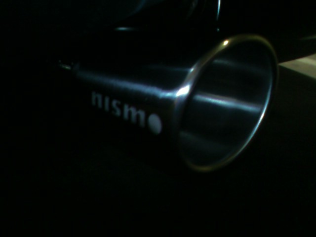

i finally got my nismo exhaust installed today. sounds really nice i could feel some gains and no its not in my head..
i have 1 question tho. my left hangs lower then my right what can i do or just leave it?
first pic is them installing and close up pic with cell cam.
nismo exhaust sound vid short also from my cell cam. more sound after i install my nismo wing. if you guys want..

You just have to adjust/bend one of the hangers.

yeah that is normal with all the nismo exhausts, just bend it a little

if one is hanging lower than the other, you can either bend the exhaust hanger, or you can put a washer on the bolts holding the rubber hanger hole to the car to lower it some (on the side too high)

It's easiest to bend the right hanger down a bit to bring the right tip down to the level of the left.

Seriosuly though, ditto on adjusting the hangers. My Borla was the same way when it first went on.
